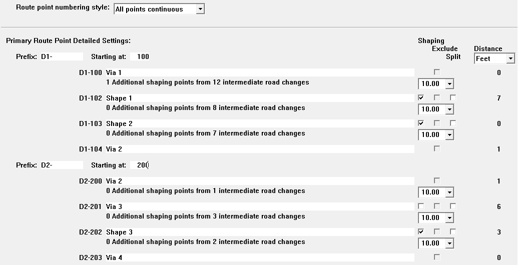

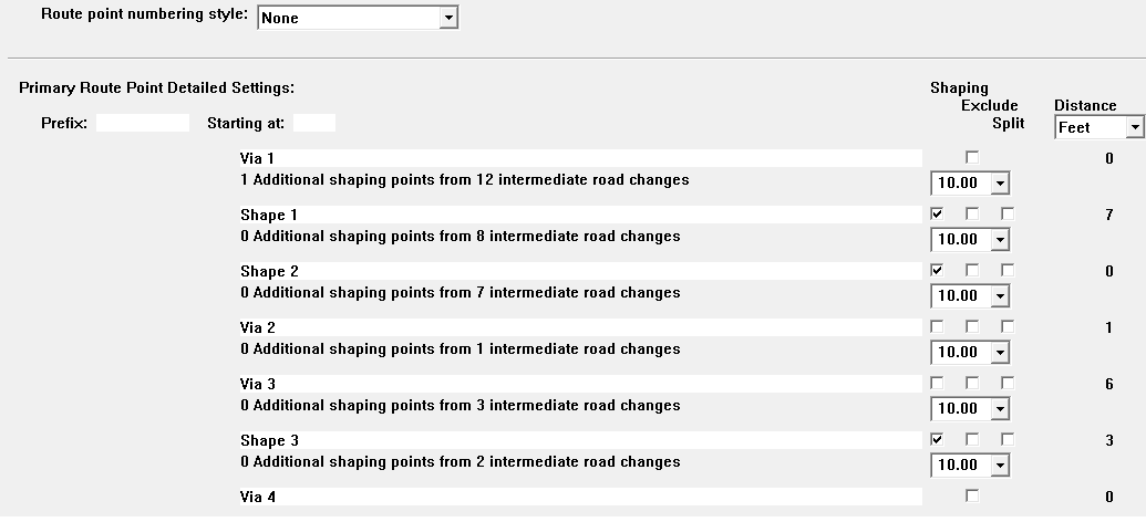

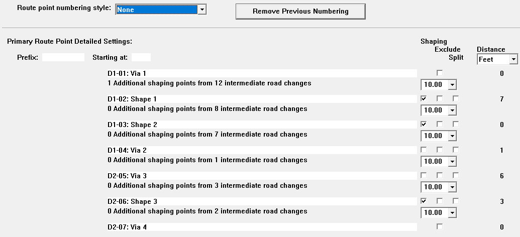

Trk2Rt can optionally add a prefix and numbering to the route points. The prefix is user specified text - e.g. "Day 1 ". The numbering is sequential with a couple of optional forms. All of that, if any is followed by a colon and a space, that is ": ".
The remove previous numbering button is designed to remove that. If clicked, it removes anything at the beginning of route point names up to, and including the ": ". For example
would become
A new prefix and number could be added from there if desired.
if your "D1-03:ShapingPoint02" had a space after the colon - that is "D1-03: ShapingPoint02" - then the remove previous button would strip that to "ShapingPoint02".
You could then use the numbering feature to renumber your points as desired.
To add the day prefix:
Trk2Rt has the ability to split a route into two or more. You could split the route at each day and then add the day prefix.
Here's an example.
On import of your initial route would look something like this (note that I set numbering style to none for clarity here) After removing previous numbering And after setting numbering style, splitting the route, and adding prefixes for each day. Note that I also set starting number values for each route.
EDIT: I should also note that you do not have to do any of this. The remove previous, the prefix and numbering are all optional. You can keep your original manual prefix and numbering if you would like.

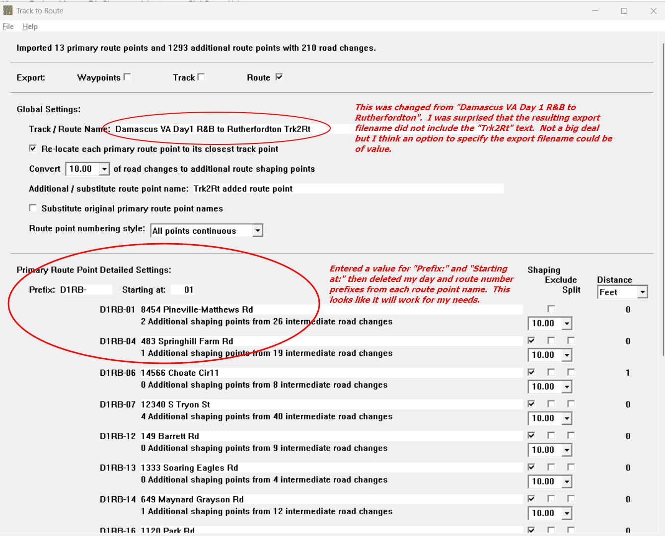

I have tested. Maybe should have done that first but having feedback allowed my to target my testing to my concerns. The image below will explain where I'm at. Something that surprised me is that the .gpx resulting from a Trk2Rt export containing only the route could not be imported into Basecamp. Is this normal?

Good to hear that the prefix and numbering will work for you.
I'll add the export file naming option to the V3.1 candidate list. It's a reasonable idea. Thanks for that.
Right now the export file name is based on the import file name. Page 6 of the user's guide provides details.
The Track / Route Name field only edits the name given to an exported track or route within the file.
Definitely not normal. I do it regularly. I suspect that the & character in your route name is the issue. See Avoid special characters on page 22 of the user's manual.the .gpx resulting from a Trk2Rt export containing only the route could not be imported into Basecamp. Is this normal?
