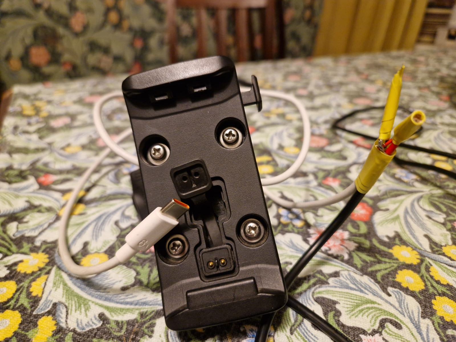

This post is about how to power my Zumo 395 Garmin. I bought a Honda Forza scooter which has USB-C socket in the glove compartment. My previous Forza had a 12v power socket. I cannot a cable to connect the Garmin in its cradle. I have soldered a USB-C cable to the Garmin cable but get only 2 volts which will not power it up.

The USB-C socket is working and charges a mobile phone. It seems all this USB stuff is not simple wiring and replies on microchips or whatever. So far I cannot find a cable with USB_C to Garmin plug to fit in the cradle holding the Garmin.

The Garmin cable is designed for a 12 volt feed. It reduces the incoming 12 v to whatever 5 v the Garmin actually requires. By supplying USB voltage, you are providing voltage that is too low and the Garmin is reducing it additionally. You need to provide 12 volt supply to the Garmin cable, wherever you source it.

Thanks for the quick reply. I forgot to say that I when I soldered the USB cable with the Garmin cable I cut out the Garmin adaptor, which steps down the 12v and puts out 5volts, which is what a USB feed is, 5 volts. Seemed simple and obvious but it doesn't work.
