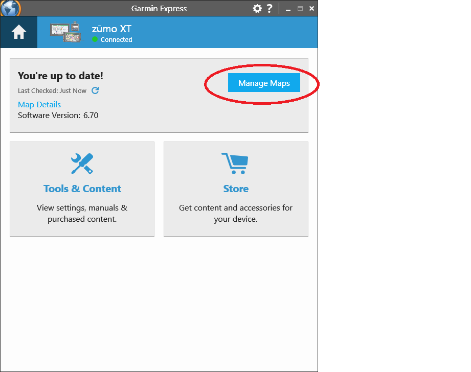

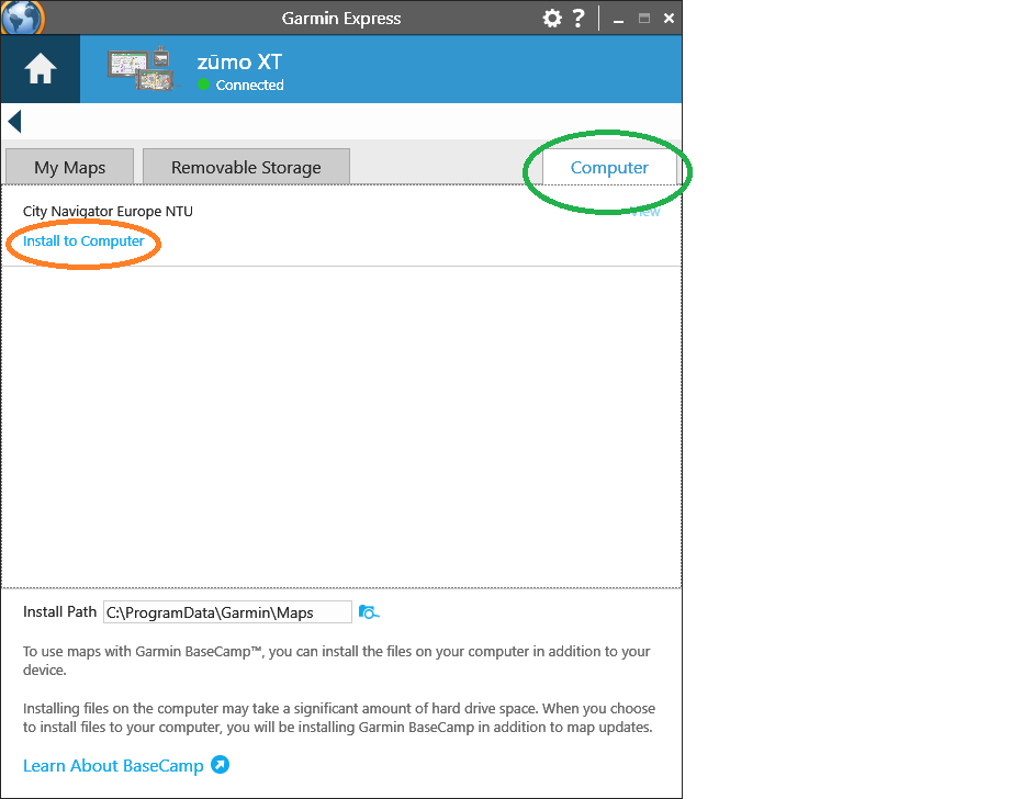

I found that you can actually do it using the "Manage Maps" option then under the "Computer" tab
- ManageMapsButton.png (55.73 KiB) Viewed 721 times
- UpdatePCmaps.png (61.55 KiB) Viewed 721 times

That was what I was expecting, although when I installed the new maps, disconnected and reconnected I no longer saw the option. Like I showed above, in the "Manage Maps" option, if you select the "Computer" tab, you can now see an option to download to the PC.
