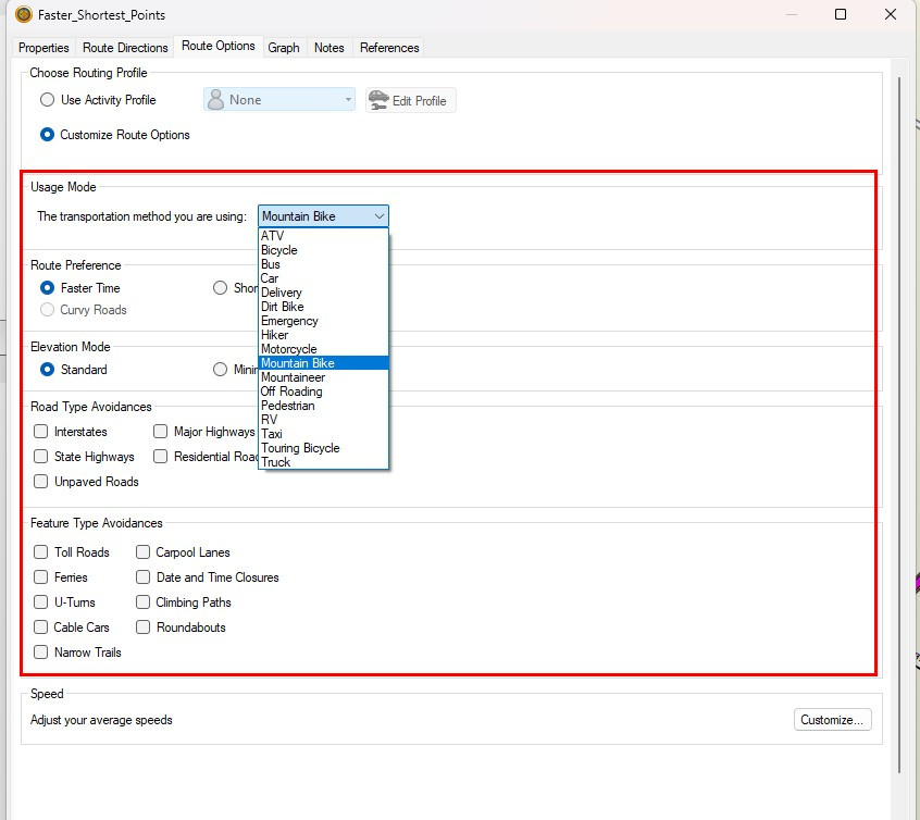

My Usage mode is set to "Motorcycle". That makes it weirder that changing a route's profile to "None" results in its route points having a profile of "Driving". There is no need for conjecture as to why. This is Garmin after all.

None - means that your route is not linked to a profile at all. Instead the settings are stored with the Basecamp Route. It is just like using selecting 'Custom' from the list of available profiles. Custom is not a profile either - but it appears in the same list so that you can say - no thanks, I don't want to use a set of settings stored in a profile. I'll set them independently just for this route.
So 'None' and 'Custom Route Settings' are the same thing.
Selecting None or Custom has big advantages when planning routes in Basecamp - because any changes that you make to the custom settings are shown immediately on the map. Make a change, the route changes immediately. So you can use this to play around - to see what will change if you allow motorways example. If you create a route that never changes no metter what settings you apply, then there is a fair chance that if the Zumo has to recalculate, it isn't going to come up with anything different.

But if you look at the GPX file that is created by Basecamp with custom route settings (ie no profile is selected), the settings for Transportation mode for me are 'Bicycle'. That is because I have just been experimenting and the last thing that I selected in this drop down list was bicycle.
But curiously, that Transportation Method is not the value that is transferred to the GPX file as the <TransportationMode> tag. It is the name of the profile that is used to determine the contents of that tag.

Normally the XT will use motorcycling settings if it does not recognise the transportation mode. So even profile names like Motorcycling-Curvy are not recognised by the XT1.
The value in Tranportation Method that you are using - which is only available in Custom Route Settings - is not sent by the GPX file, so the Zumo doesn't see it. The XT will default to using 'Motorcycle' preferences that have been configured on the XT itself.
