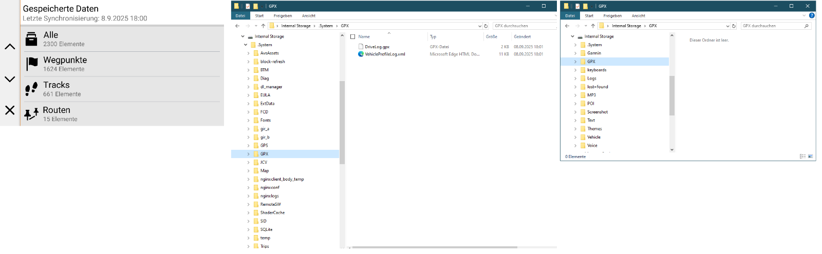

Before asking here, I already searched thoroughly ;-)
Device GPX Folder.png (112.71 KiB) Viewed 478 times

You can see in the pictures,
that both folders are empty, yet I have countless tracks in the device ;-)

Didn't notice the right window. Sorry.
Put 1 track in Internal Storage\GPX, restart the Zumo. Do you have 662 tracks then?
How many tracks are there in Explore.garmin.com? Maybe an error syncing?
If that fails copy the entire Internal Storage to your hard drive. Searching works better on a hard drive.
EG
Code: Select all
Dir *.gpx /s
