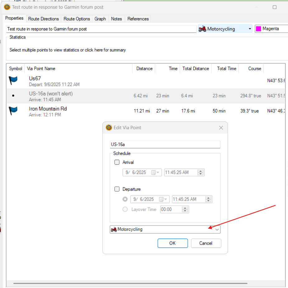

To set the Profile of a specific segment you open the properties of its starting route point and change is Profile. Must do this from a route detail window.

I just grabbed a test route to use to show where the route point profile setting. I think I have only done it with with Via points although my usage has always been to force Basecamp to route between two route points so I wonder whether the CalculationMode not being in the GPX was relevant if the ghost points were, as long as a recalc didn't happen.

Ah thanks, @Peobody .
I was looking for the wrong thing.
I'll check out what the gpx file looks like after this has been applied.

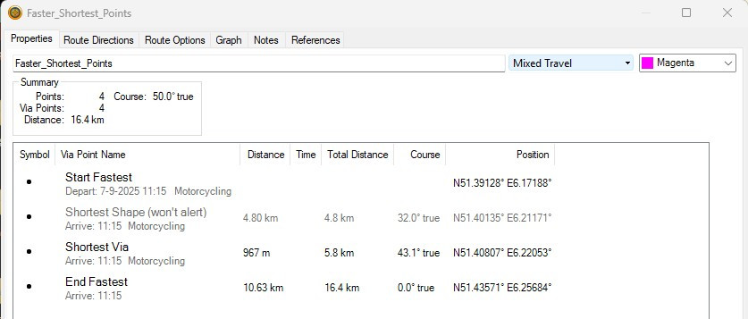

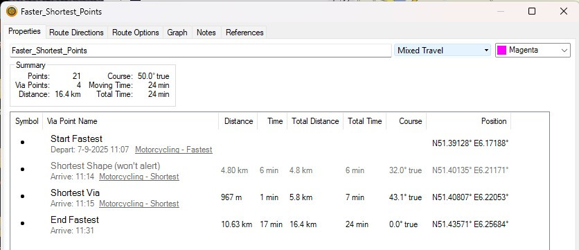

Consider this small route in BC:
The start and end have MotorCycling Fastest, The Via and Shaping have MotorCycling Shortest
With my profile definitions when exported this results in a GPX that has NO CalculationMode for the shaping point.

It gets even worse when you import that GPX back in BC (Delete first if you try this)
Every thing is reset to the default MotorCycling. I assume that is based on the TransportionMode. But the key point to remember is that when BC imports a GPX it does not always use the CalculationMode of the Via/Shaping points.
For the XT (that we both have) you would indeed have to make sure the trip/route does not get recalculated.
The trip file format only has 1 setting for the RoutePreference=Calculationmode. There are no items per Segment as the XT2 and Tread 2 have. So it can only use 1 mode for the complete trip.
For the XT2, and Tread 2, you can set the RoutePreferences for every segment in the Tread App. A segment is from one Via to Another Via. It can not be set for Shaping points. I can tell that by looking at the trip file format, not because I know how the Tread App works.
It would need to be tested if the GPX import process uses the CalculationMode to set the correct values in trip file.
