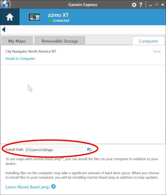

I did panic a bit when I opened the Map Options and did not see Install to Computer, but then I read your post more carefully and found Manage Maps.
I was excited to see a box for Install Path again, but sadly, it is ignored and the map ends up in C:\ProgramData\Garmin\Maps\ just as it has for the last few years.
2025-08-15 22_24_41-Garmin Express.jpg (47.65 KiB) Viewed 1156 times
It is possible to move it to D:, but making up the new shortcut in a hidden folder is an extra step that should not be necessary.

The move of the install map to computer function to "Manage Maps" is logical but I suspect it will trip a lot of people up. Thanks @lkraus for explaining it and for the screenshot.
lkraus wrote: Sat Aug 16, 2025 2:38 am It is possible to move it to D:, but making up the new shortcut in a hidden folder is an extra step that should not be necessary.
More info about this please. I am unclear about what it means.

At one time you could choose an alternate map location in Express and Express would do all this automatically. Then there was a period when you could specify another folder, but then it was ignored. Recent versions of Express did not even provide the option to change the location. So I was glad that 7.26 let you specify a new folder, but again disappointed that my wishes were ignored.

lkraus wrote: Sat Aug 16, 2025 2:38 am I did panic a bit when I opened the Map Options and did not see Install to Computer, but then I read your post more carefully and found Manage Maps.

Well, as I said, at one time Express did put the map wherever you wanted it. It just put a shortcut in the default folder C:\ProgramData\Garmin\Maps\ and then Basecamp would follow the link. The manual method does the same thing and works well, but it is a bit of a nuisance until you've done it several times and memorized the steps.
The same method works with my seldom-used OSM maps for foreign countries I'll never visit. The default map folder on C: only contains shortcuts to my D: drive.
It is still quite annoying that Express lets you specify the desired destination but then completely ignores your choice.
