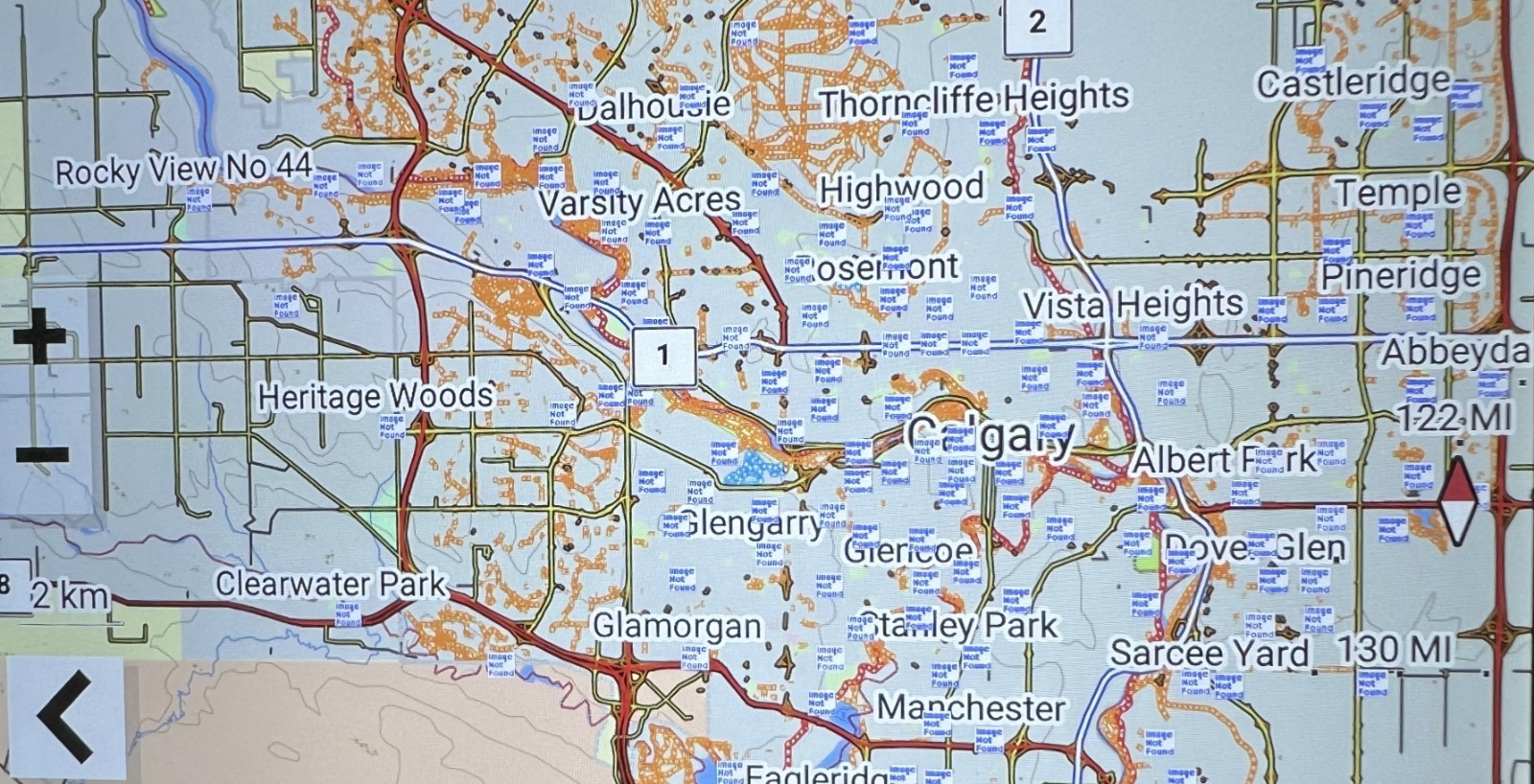

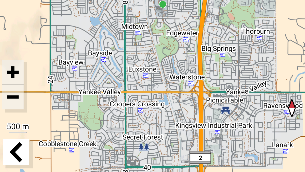

My overall initial impression of the XT2 is positive. However, I'm having an issue with many of the symbols/icons in the map view on the XT2 showing up only as small white boxes with blue text that reads "image not found". The number of missing symbols varies, and seems to depend on what the "map detail" setting is on, how many layers are showing, etc. - basically, it seems like the more information the map is showing, the more of these symbols are shown as "image not found". I've attached screenshots of a couple of examples: Example 1 is what I see when I turn off most of the layers, Example 2 is a more extreme case with most of the layers turned on.

- Example 2.jpeg (432.86 KiB) Viewed 392 times
- Example 1.png (1.04 MiB) Viewed 392 times

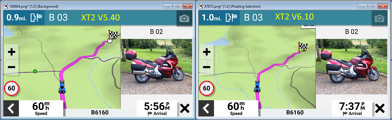

This was a couple of screen images that I sent to them. Same gpi file. Same location. v5.40 software shows the POI location, v6.10 of software does not.
Neither does it show up on the information screen when looking at individual POIs.
