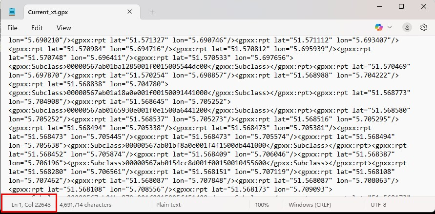

There is no way I can prove it, but this is my theory. To explain it better please open a current.gpx in Notepad. You will notice that everything is on 1 line. There are no Newline (0x0a) and/or Carriage Return (0x0d) in the file. you will see something like this.
Notice that it doesn't matter how far you scroll down, the LN remains 1
This is perfectly valid XML. nothing wrong. EXCEPT.....
Programmers are tempted to write programs that read this line by line. And to do that you need to allocate a buffer to hold the complete line. In this case because it's only 1 line, the complete file! And I ASSUME that the programmers that wrote BaseCamp did not allocate a buffer large enough to hold the complete file.
Just how big is the current.gpx on your XT2?
That is my explanation, or better my theory.
I dont have a solution for the BaseCamp problem, except the one that @sussamb already mentioned. Just clean up.
