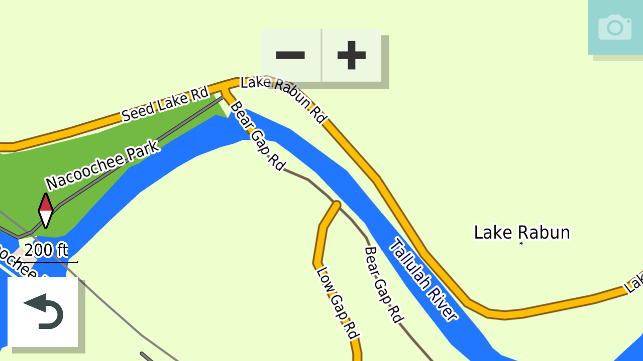

My wife and I just returned from a 3 day getaway to northern Georgia. While there, I used my XT for the first as tool to search for a POI and then let it get me to it. I have the unpaved avoidance enabled but twice it routed me on unpaved roads. Could this be explained by the fact that there weren't any paved roads to the POI? If so, should I have received a notice advising that the route contained unpaved roads?
While thinking about this behavior I wondered whether it was due to paved/unpaved errors in the map. As I watched the map I noticed that unpaved side streets were colored brown or black. A significantly more unpaved ones were brown, and I never saw paved on colored brown so does brown=unpaved? If so, there were a lot of paved/unpaved errors in the area we were in.

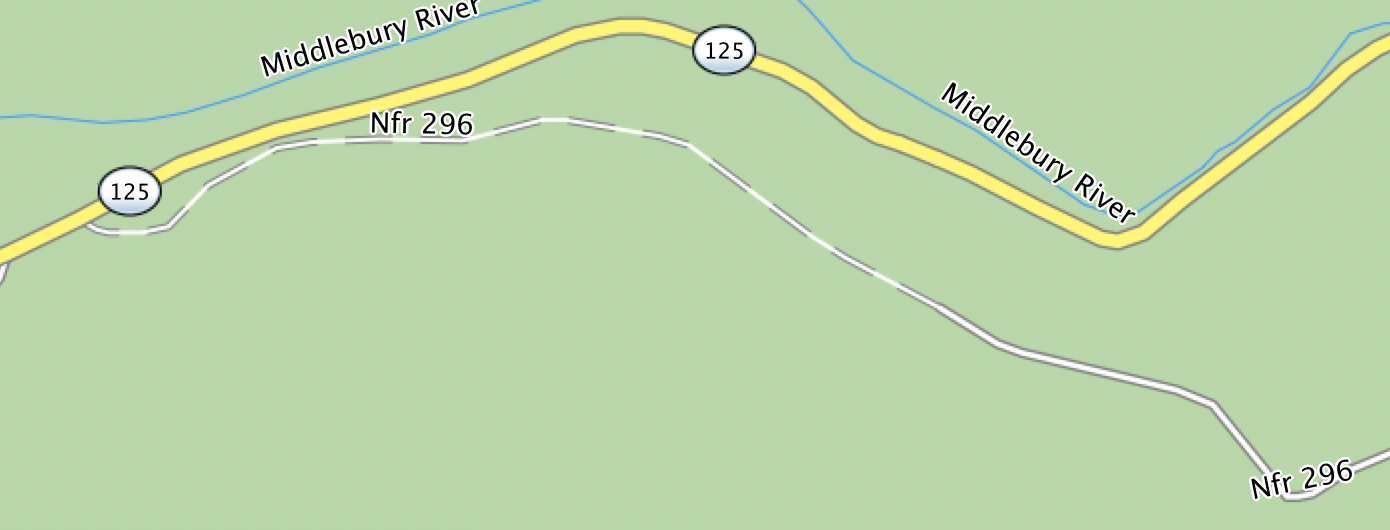

As I plan day rides out of Killington, VT for an upcoming July trip, I find that looking at the Garmin map in Basecamp, zoomed in, is a reliable way of detecting dirt. To be fair, I have not checked the same roads on the XT, but am confident that a larger screen helps a lot, right down to showing exactly where a paved road turns to dirt.
I realize your issue was "in the field," so BC was not an option, but mention this in case it helps with troubleshooting the errors you found or future trip planning.
Here's an example: -dan

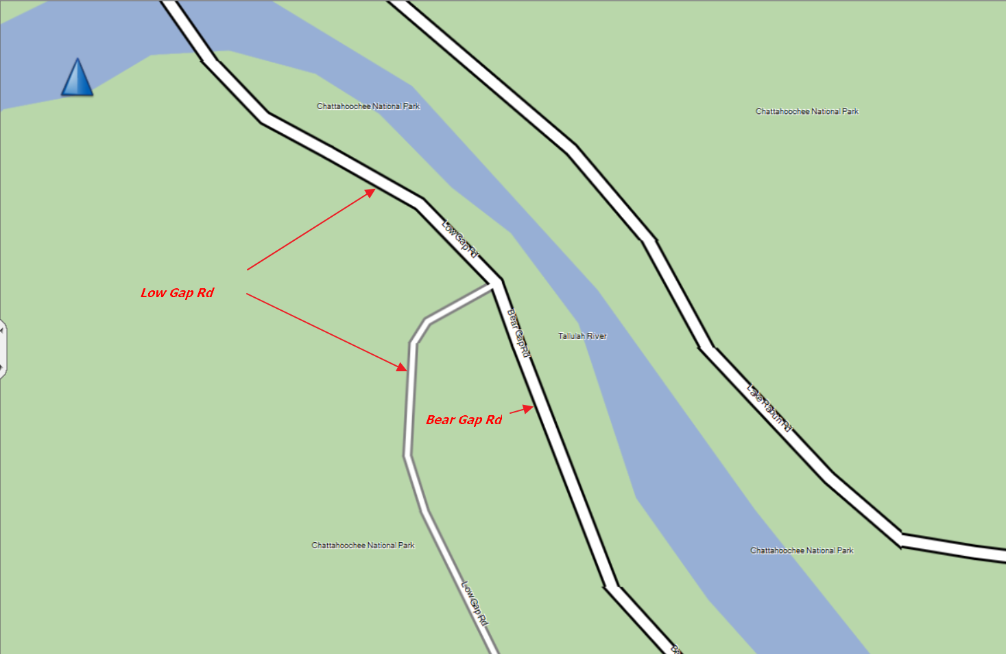

You're right Dan. I look at that, as well as using Google Maps, whenever there is a question of unpaved or paved during route planning. I just fired up Basecamp and looked at one of the unpaved roads that I was routed on (Bear Gap Rd in the images).. Basecamp shows it as paved which confirms a map error. Surprisingly, the smaller Low Gap Rd is paved. I remain curious whether brown roads on the XT indicate inpaved.

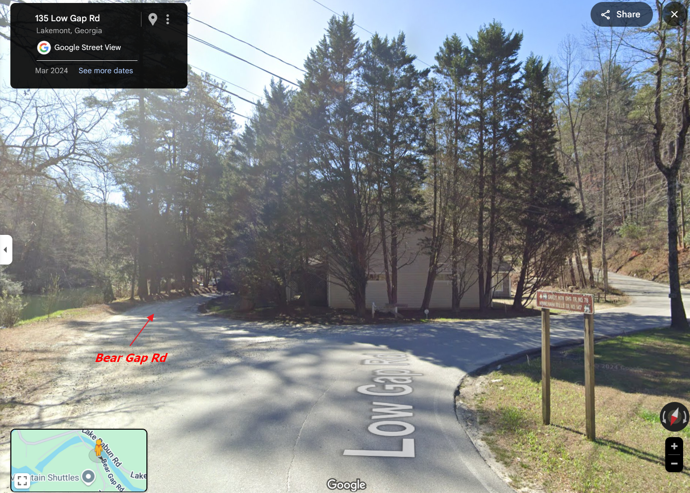

Colors are determined by the map data. I can distinguish between paved/unpaved roads easier with the thin brown lines of this Open Street Map:
Though any map can have errors. This OSM map shows Bear Gap Rd as unpaved (and misnamed?) west of the Low Gap intersection, though the Google Street view shows that it is paved:

I just spent a good bit of time comparing brown road on the XT with what Google Maps showed. All are unpaved, but so are many that are shown as light gray on the XT. What I am realizing is that when using the XT to manually navigate, there isn't any way to know that an intended upcoming turn could be onto an unpaved road. I still haven't figured out what the brown road color indicates. FWIW, my map detail is set to Normal and map theme is "Garmin".

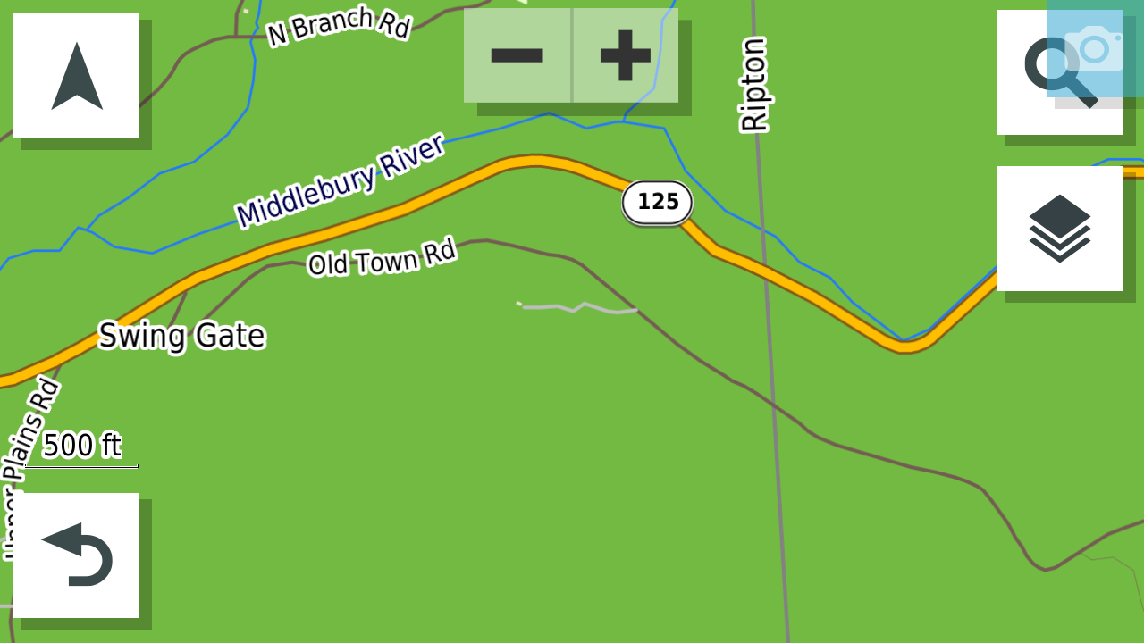

@Peobody I believe the brown color is indicating an unpaved road.
I live in the United States (Georgia), but have been using a customized UK map theme on My Zumo XT to display the map. I edited my map theme file to widen the brown lines that are displayed for unpaved roads.
I have also experienced the mapping errors you encountered. I have encountered unpaved roads that do not display as unpaved on the GPS. I have also encountered Basecamp calculating routes using unpaved roads, even though I have Avoid Unpaved Roads checked as an avoidance. It is pretty clear that Basecamp's roads surface data is not entirely accurate. Incidentally, I have set the avoidance for Unpaved Roads in Basecamp and my Zumo XT, but Basecamp still creates routes that try to use unpaved roads.
The problem has become so annoying for me where I live (rural mid Georgia) that I have started creating a custom map overlay that displays the unpaved roads that I know about as colored (brown, I think) tracks. I create the map overlay using the TrickTracks.org website. Some of these unpaved roads I have "discovered" while others I find as I scout potential routes using Google Earth and Google Streetview.
