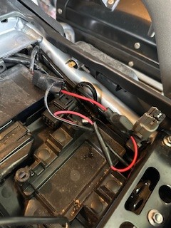

My wiring does not go directly to the battery. I use an alternative power setup I found on youtube two year ago that ties the Garmin power cord with waterproof connectors to my 2023 Tiger 1200 auxiliary power unit under the rear seat. I don't need that auxiliary power point, so I unplugged the Tiger power relay under the seat and am powering the Garmin off the relay which is live when the bike's power is on.
wiring
wiring
