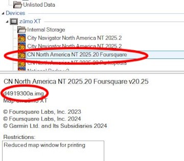

The map filenames do not match the map name. For instance, the 2025.20 Canada & Mexico City Navigator map is D9644080A.img. The filenames can be found in Basecamp:
The U.S. file is over twice the size of the Canada & Mexico file.
Be cautious in the .System folder, there is a reason it is hidden, and there are things in there that you may not be able to replace. Working in .System/Maps should be fairly safe. I think anything in there can be replaced by updating/reinstalling maps with Express.
