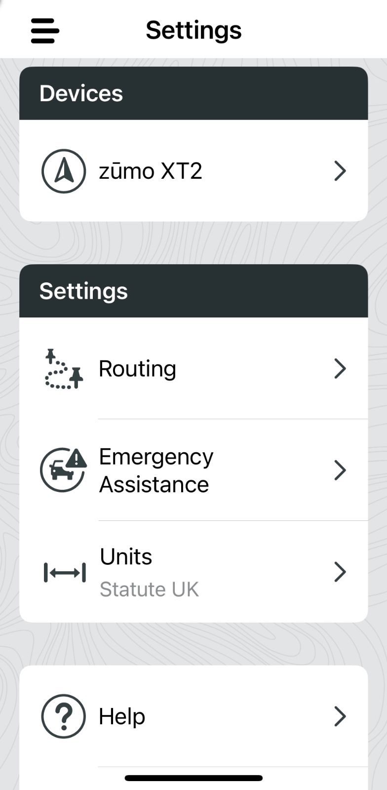

According to the user manual I should see smart notifications, txt messages etc, on my XT2 when it connected to Tread app on my iphone 15.
I always have Tread connected but I’ve never seen any text messages notifications on the XT2 screen.
Anyone know how to make smart notifications appear on the XT2, there’s no settings for smart notifications in the Tread app.

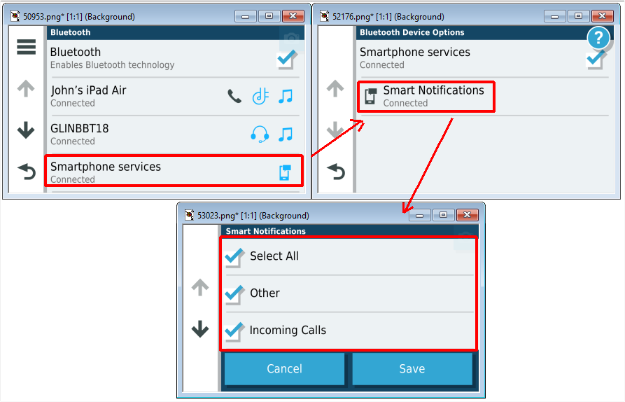

On the Android there is another option between Routing and Emergency Assistance called Smart Notifications. In there you can turn on notificatuons for eg Alertd, Emai, Messages etc - 7 items in all.
If you have an iPhone, I don't know.
However I checked something similar on the android and on the ipad with the XT and the Drive App. On the Android there was a similar set of settings - whic were not present on the ipad. However, when I eventually connected the ipad to the XT - the but the same notification options and more were available on the Zumo itself. I've just found the post that I made at the time.
Goodness know whether or not this is the case for Tread. But it seems likely. Sorry - I cannot check - I do not have an iphone, and it takes quite a while to make my XT pair with my ipad so that it thinks its a phone.
On the XT2 find what might be the equivalent of the XT's Bluetooth->Smartphone Services->Smart Notifications. Possibly in Settings->Phone->phone name ..... and scroll down

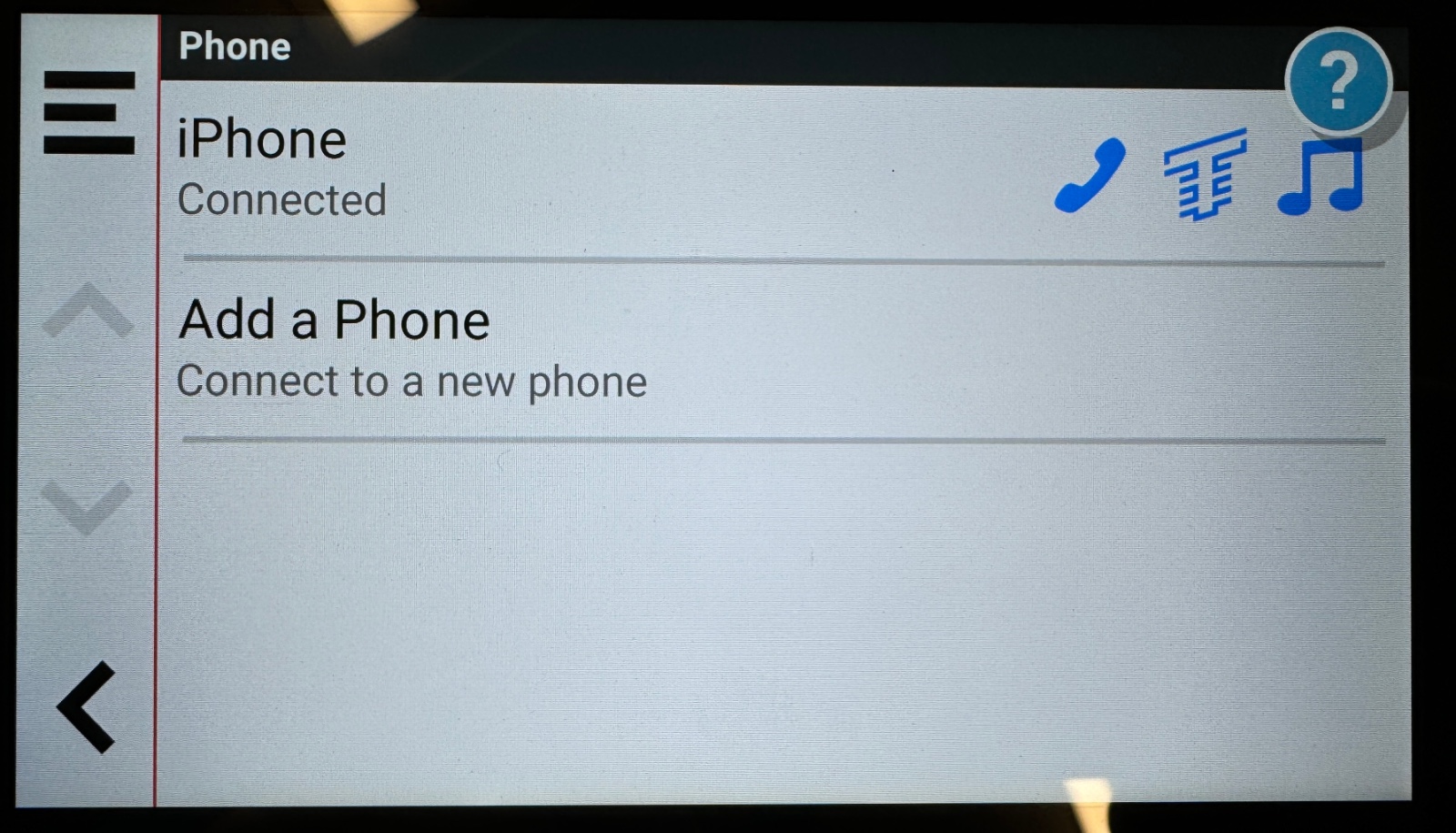

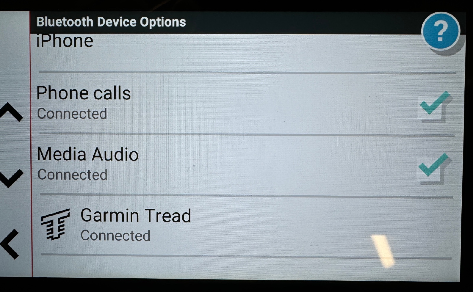

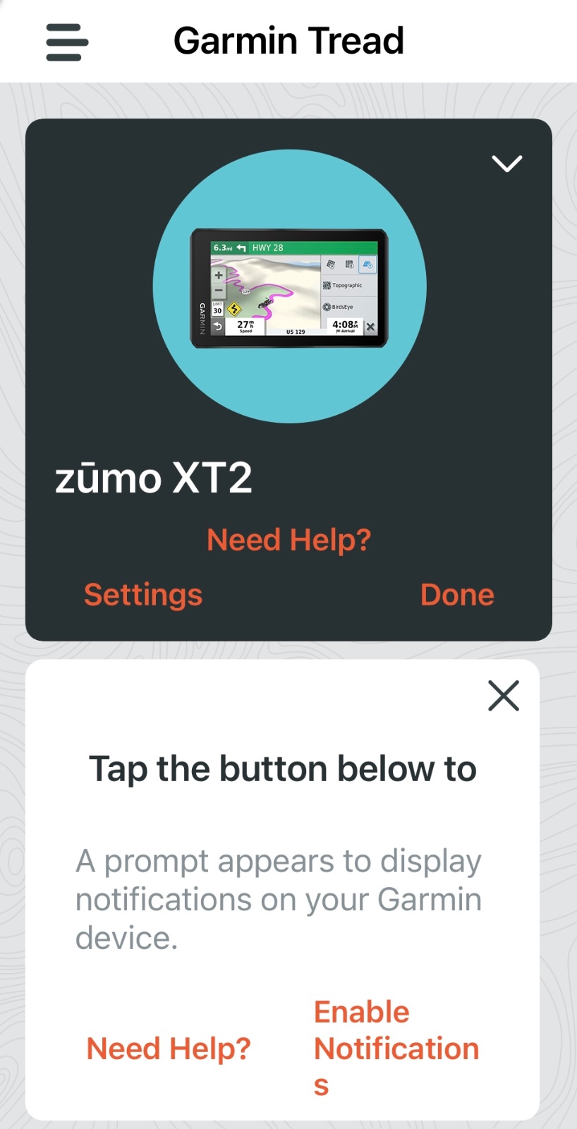

Thanks for the reply John. I’ve gone through every setting I can find, both on the XT2 and on the iphone Tread app.
On the XT2 phone settings it just says my iphone is connected for calls, media audio and the Tread app.
On the Tread app, theres a setting to enable smart notifications; when I select this it puts a pairing code on the XT2 which I press OK to confirm it matches the code displayed on the iphone. I also select “pair” on the phone. I followed this process when I originally set it up, but I’ve just done it again in the hope it refreshes something.
I’ve just ran another test, getting someone to send me a text message, but it still doesn’t give any notification on the XT2 screen.
It seems that the XT2 when used with an iphone cannot display text msg notifications.

This section of the manual syas that it is possible and you get an icon alongside the phone to show that it is connected. Along withe the phone, music and Tread icons. That sounds very much like what I have seen on the iphone with Drive and the XT1
https://www8.garmin.com/manuals/webhelp ... E2294.html
This is was the XT looks like when the ipad (pretending to be an iphone) looks like when it is connected.
The list of 3 smart notifications shown - is actually about 3 times as long as that.
I hope someone who has an iphone is able to fill in the blanks if they see this post.
