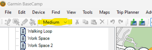

Hi all. I have done zero updates or changes in I-don't-know-how-long. But something has changed and I can't figure out how to go back. My Base Camp map of a big city is so cluttered with the History Channel 'H' that I can't read the danged map! I have searched and searched but I can't find how to undo this unwanted History Channel crap. My first thought was in maps, top left but there's nothing useful there. Any ideas? Also- you must use the KISS method: Keep It Super Simple if possible, and include instructions of HOW to do something & not just a list of what to do. I'm really ignorant about this, obviously. Thanks!

I have never seen a symbol that looks like the History Channel logo but I know that the map detail level controls whether the enabled symbols are displayed. If it is set any higher than Medium, change it to Medium and see if that takes care of it.

Peobody wrote: Mon Aug 19, 2024 12:01 am I have never seen a symbol that looks like the History Channel logo but I know that the map detail level controls whether the enabled symbols are displayed. If it is set any higher than Medium, change it to Medium and see if that takes care of it.
Selecting as you say works until I zoom in to see details then the History Channel logo shows up again.
