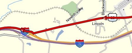

Yeah, as noted in a reply, double click route name to open properties box, change color. You say you "assign differnt colors", how are you doing it.Peobody wrote: Wed Jul 10, 2024 11:32 pm I have tried assigning different colors but many of them hide the map markings behind the route line. How do you experienced Basecampers deal with this? Have you settled on a select handful of colors? Something else that differentiates routes?
And please, tell me what "I have tried assigning different colors but many of them hide the map markings behind the route line" means. That makes no sense to me.

ALL of the colors for a selected route are bold and opaque - they ALL block highway markers, which are placed on the road. Text road names sit next to the road and usually peek out from under the color. Un-selected routes are muted and somewhat transparent.

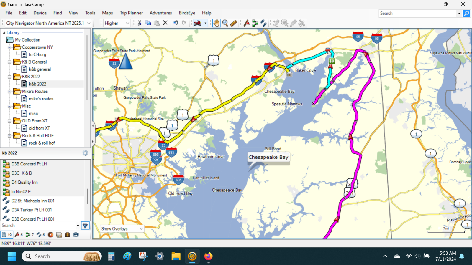

Re: What colors do you use for routes?
Yup. Below is the upper portion of my current Library list.
BTW, if anyone is frustrated by Basecamp always opening to routes displayed on the map, notice my first Library folder is named "_Blank Map Display". This is an empty folder. The leading underscore in the name sorts it to the top. I select it before shutting down Basecamp resulting in Basecamp always opening with an empty map. I'm sure some of you prefer it to open to the route last being worked on but if you like a clean slate from which to chose what you want to work on, this method works well.
