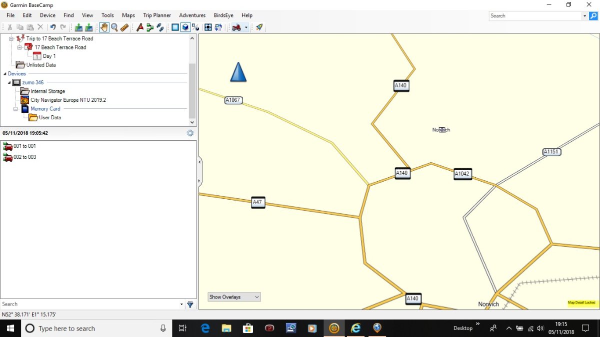

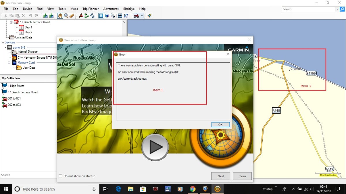

So I tried with BC and felt I was banging my head against a brick wall..
The screen shot above showed the map to be something "Stick Man" would be happy with.
Item 1 is a comms error to the Zumo.
Item 2 suggests that the roads around Cromer are in the Tidal Zone (Let's not get started on that subject or I'll kick off the "Crab Wars" again

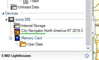

1) When you plug your zumo into your computer and open Base Camp, on the left, are you seeing your device and your memory card listed separately? I've attached a picture below showing mine, I would expect yours to be similar.
sussamb brings up a good point about formatting but we'll get to that. In newer zumo models card formatting on a computer is not required, the zumo does it when you insert the card. Plus, I found out that FAT32 formatting is kind of old hat, my relatively new laptop doesn't have that option. So:
2) What other info do you have on the card? Is it anything that can't be easily replaced if a new card is purchased and tried? I'm NOT saying run out and do this yet, just curious.

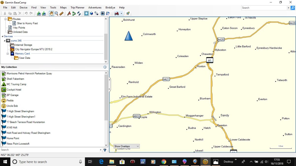

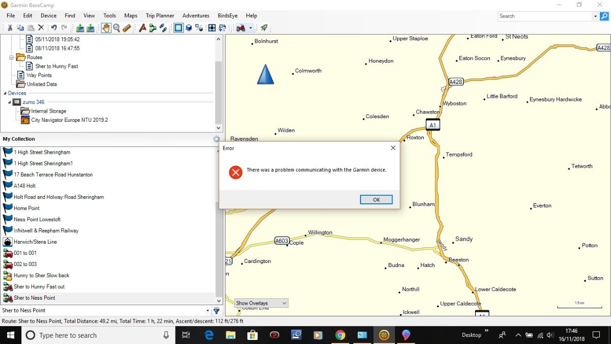

Right I have some screenshots of my Zumo connecting to BC
As it could do nothing disastrous to my routes waypoints, I opted to re-format the card with FAT32 file format
This first one always comes up
Followed by this one......
So clear the alarms and we have this screen....
Zumo is there with Internal storage and Memory card with Folder <USER DATA> configured.
Sent a route to the memory card <USER DATA> and got the Green Tick on the folder
However when I re-start Zumo it still does not recognise that there is something on the card.
