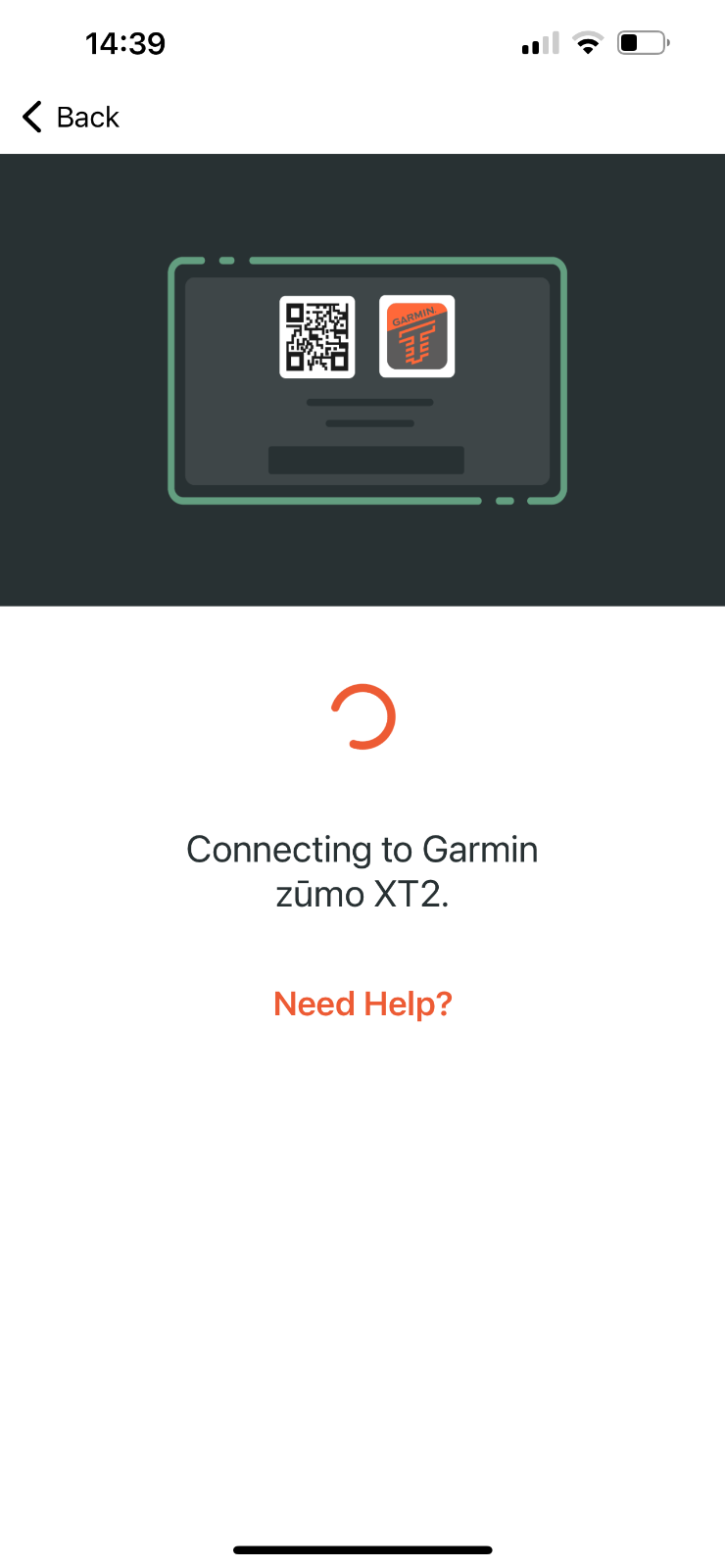

by nigelpugh7
Hi Guys,
I’ve just invested in the new Garmin Zumo XT2 to use on my Honda Africa Twin.
I can’t seem to get a proper connection at all to the Zumo using my IPhone 13.
It. Connects partly, but won’t connect to the threads app.
Is this the bugs in the app as mentioned above?

Re: Tread app not syncing to XT2
Posted: Sun Jun 09, 2024 3:46 pm
by jfheath
Welcome to the forums !
I think that your phone may be connecting to something else rather than to the XT2. Your iPad Pro perhaps ?
Take them both away from any other devices. On the phone, forget the Zumo. On the Zumo, forget the phone.
Take then both for a walk away from other devices, and get one to search for the other.
That may fix it - but you will need to check that the phone doesn't go playing away the next time it goes back into the house, preventing your XT2 from connecting. Remember - your XT2 will keep turning off if it doesn't have a constant supply, and it will break the connection.
But once established - my XT2 and phone connect first time every time when they see each other. And it will connect to other devices as well - but once it has its priorities right ....
