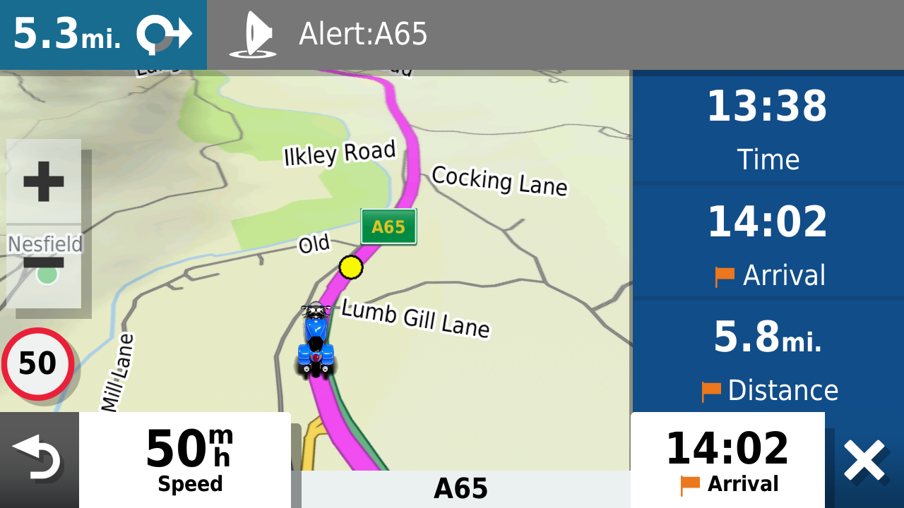

The image below shows the bike approaching a custom made yellow POI when following a route.
Note the announcement at the top of the screen. An mp3 file is played at the same time

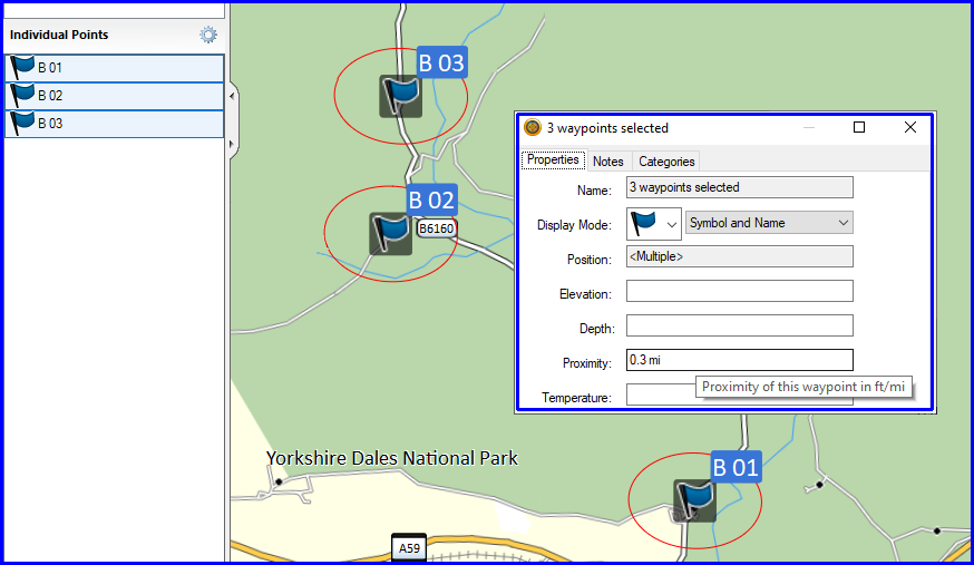

The above picture shows the Basecamp screen. Click the image to see a better quality version. On the map I have placed 3 Waypoint - marked with the default blue flag. The blue flag is not relevant to this exercise.
On the left, the lower left window pane shows the 3 Waypoints. I have selected all of them by clicking on the top one, then holding the shift key down and clicking on the bottom one. All three are highlighted in light blue.
Right click and select 'Open'. BC cannot open 3 dialog boxes at the same time, but it can open one and the information that is entered will then be set for all three Waypoints. I am going to set the proximity to 0.3 miles.
That proximity value is indicated on the map by the red circle that is around each of the three points. It indicates how far away from the point you will be when the alert is given.
Save all of your Waypoints into a single GPX file: In Basecamp, select the Waypoints as described before.
File -> Export -> Export Selection - and find the location of your folder and give the GPX file a name.
eg mine was saved in J:\IndPoi\IndPoi.gpx

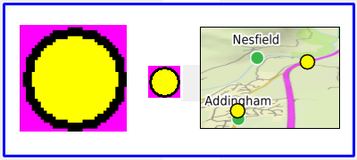

#4 Create an Icon and an alert sound.
First, Create the Icon
The Garmin documentation, such as it is, requires the image to be
  • 24 x 24 pixels - this is about the size of the blue disc shaping point. I have tried larger sizes - 36x36 and 48x48 and both seemed to work on the XT. 48x48 was a bit large though. Although they worked on the XT, the Garmin documentation specified 24x24 - so they might be a requirement for earlier Zumos.
  • 8 bit or 16 bit colour code (8 bit gives 256 different colours, 16 bit gives 65,536 different colours). 8 bit is plenty !
  • Saved as a Windows / OS2 bitmap file with the BMP extension.
The picture below shows the 24 x 24 image. On the left, I have enlarged it to make the idividual pixels very clear. The smaller version is what it looks like in the editor actual size. On the right is how the same icon appears on the XT screen.
Image Compare.png (30.19 KiB) Viewed 9176 times
The magenta colour (RGB = 255,0,255) will be regarded by the XT as transparent. All you will see is the black and the yellow - the magenta will not be seen and anything that is behind it will be seen.
Save the bmp file with a name that you will recognise as belonging to this collection of POIs.
Save it in the same folder as before - eg J:\IndPoi\IndPoi.bmp

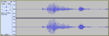

Create a 'Ping' ... alert sound
This can be any mp3 file. It needs to be resonably loud and could be a simple ping sound or a voice recording, or a complete piece of music. Up to you. Audacity is a free piece of software that allows you to edit and create MP3 files. Google it. It's free. It is brilliant.
Find or make a sound and store it in your folder. I created one with me saying 'Point One'.
So that is saved as J:\IndPoi\IndPoi.mp3

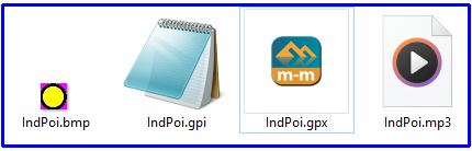

You should now have the following 3 files in your specially created folder.
Saved Files.png (13.58 KiB) Viewed 9176 times

So we now have 3 files inside a folder that we created. In my case J:\IndPoi\
Saved Files.png (13.58 KiB) Viewed 9174 times
I have called them all by the same name, but they have different extensions. If you do a few of these, you very quickly get confused about which files belong with which collection. It makes a lot of sense to identify them with a name that matches the name of the folder that they should be in.

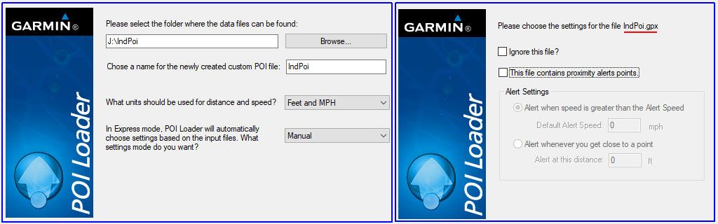

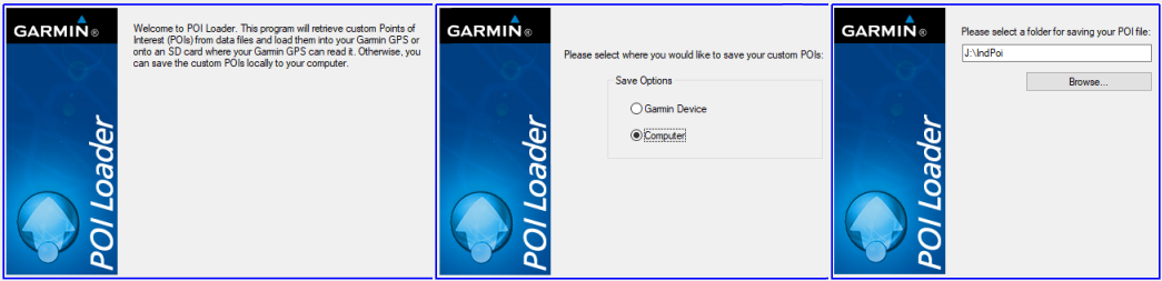

Run POI Loader
POILoader is free software from Garmin.
Download from here for Windows.
Download from here for Mac
Click image to see a clearer version
POILoader 01.png (118.09 KiB) Viewed 9174 times
POILoader 02.png (73.44 KiB) Viewed 9174 times
Note the underlined item in the bottom right picture (above). You should have only three files in the folder that you specify. One of those is a gpx file. IT actually doesn't matter what you call it - but my system of using the same name for the folder, the gpx, bmp and mp3 files makes this step easy. If it finds other gpx files it will show them on this screen - and it gives the option to ignore. This is where mistakes can be made. Just have the 3 files and there won't be any problem.
Also note that I have not ticked the option for proximity alerts. That is because we set them for the waypoints that we created in Basecamp.

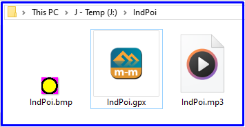

And that's it for POI Loader. The J:\IndPoi folder now contains an extra file - the IndPoi.GPI file that it has just created.
Completed POI Files.png (25.54 KiB) Viewed 9174 times
The IndPoi.gpi file needs to be copied to the Zumo. Put it onto SDCard/Garmin/POI folder.
If the folder doesn't exist, create a Garmin folder and in that create a POI folder. Capitals where I have placed capitals.
You can ask POILoader to put the file onto the 'Device'. If you do, it will put it into Internal Storage / POI along with a long list of other POIs - which it typically uses for speed cameras.

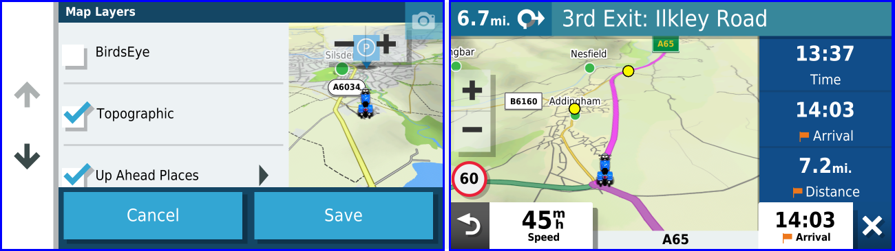

*** Up Ahead Places
'Up Ahead Places' must be ticked in order to show Waypoints and POIs on the map.
Unfortunately it also shows up three other categories as icons on the screen. If you don't want this to happen, then the following will stop those big green icons from cluttering up your screen. It will still show up Favourites though.
Settings -> Map & Vehicle -> Map Layers
Up Ahead Places needs to be ticked. Tap the black arrowhead.
This gives a list of three items that it will search for and display down the right hand side of the map.
I have my list set to three things that it will probably never find.
05 Up Ahead Places.png (9.28 KiB) Viewed 9171 times
To change the top search item, tap the top row and then select 'Custom Search'.
Where it invites you to enter a business name or category, Enter 'Xxx'. Done. Choose an icon. Save.
Repeat for the other two with (eg) Yyy and Zzz searches.
Although it suggests that a Category can be named for the search, I have been unable to get it to locate the Custom POIs for the 'Up Ahead' display that can be shown on the RHS of the navigation screen.

Just a detail: the magenta background of an icon displays, while it is supposed to be transparent (not to be displayed).
I read an older post of yours where you had this same "problem".
May be it is due to the image format? Apparently, you no longer have that problem anymore.
