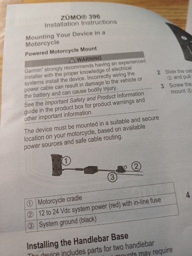

here's my 396 Instruction Sheet, it shows an in-line fuse on the cord but this cord in my hands has no such thing, and no fuse holder in the box either, I am suspicious now what Garmin has done to this cord, I wonder if this black box on the power cord already includes the in-line fuse inside it. because to my thinking Garmin would have included a fuse holder in the box if one was needed, that's what I'm thinking now. If i am right then Garmin needs to print new Instruction Sheets.

found it, seems that Garmin has made a change to the power cord needing an in-line fuse holder on the 396.
https://support.garmin.com/en-CA/?faq=o ... tab=topics
