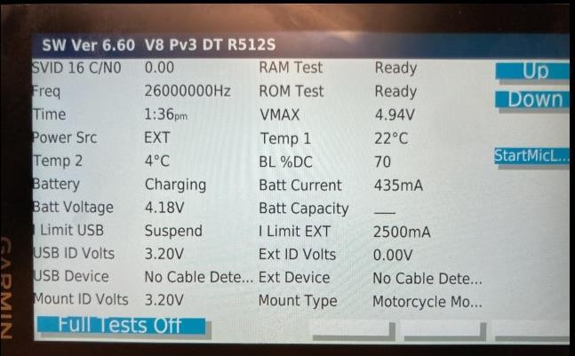

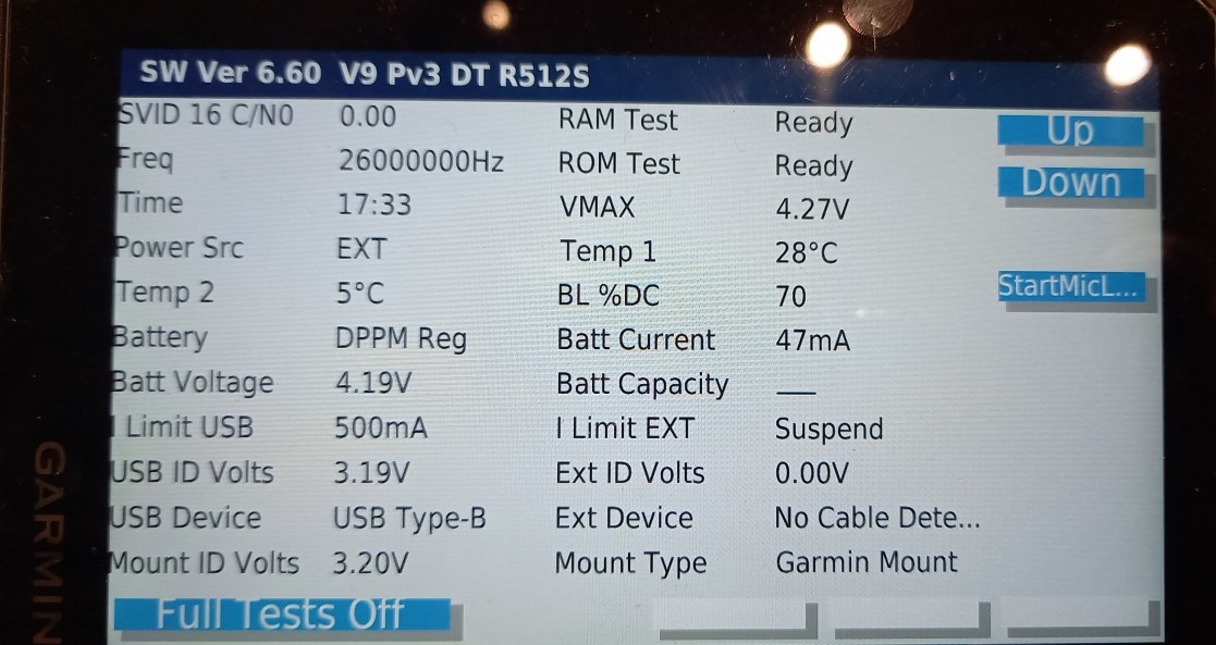

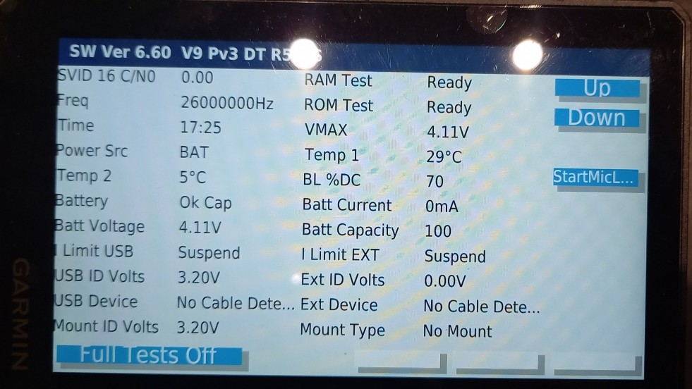

Have you viewed the battery diagnostic page ? Hold the battery icon on the main screen for about 10 seconds.Peobody wrote: ↑06 Nov 2023 17:01 My norm is to have battery brightness set at around 40% but I had pushed it to 100% early in the trip when looking at the GPS outside off the bike. If this is the only clue to power loss then power loss is indeed a possibility. I think it would have had to have started the previous day since I was only a couple hours into that days ride when it acted up. The first time it happened was a little different and I think less likely to have been a power loss although the one common factor was that it wouldn't wake up after going to sleep.
I'll attach a pic of mine in a minute. ............
This is just unplugged from the USB cable in the USB socket in the mains wall socket. It's fully charged.
If I plug it back into the power -
The three buttons on the bottom are EXIT, BACK, NEXT.
If you press them it gets into a sequence of displays - go tot he next by tapping the screen.
If you get into a display of slowly expanding coloured concentric rectangles, then press bottom left, top left, top right, bottom right in order.
And don't ask how I managed to find that out.
DPPM is Dynamic Power Path Management - which allows hand held devices to be used eveb when they are charging.
THe screen display is dynamic - so if you plug in the USB cable, it changes immediately to reflect that. I guess that it will also reflect the change when it is attached to the cradle on the bike.
