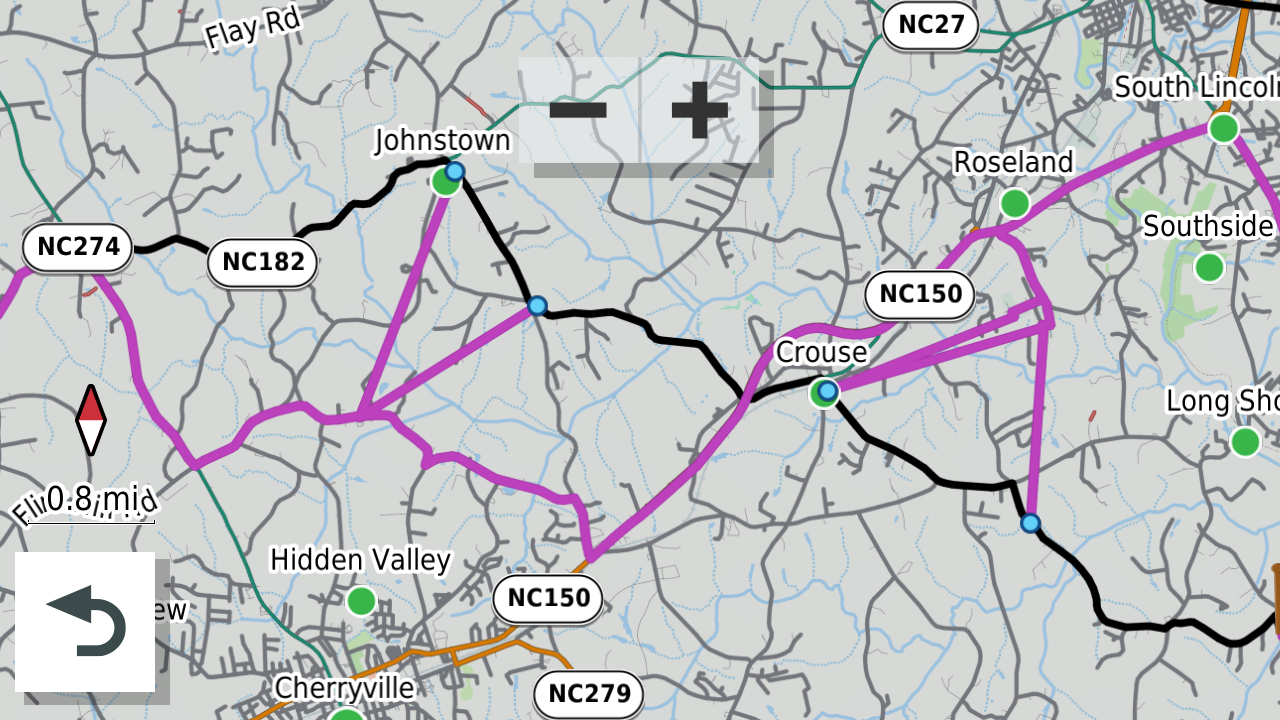

I returned home from a ride about an hour ago. Priority one was to share a screenshot of insane routing that occurred when the XT reacted to a road closure ahead. I was heading West to East. The road closure was offscreen a little bit to the West. The black line is the track of my intended route.
I am posting this solely for its humor value. Well, maybe for its absurdity too.
Screenshot of wacko traffic recalc.png (897.85 KiB) Viewed 2601 times

FrankB wrote: Wed Sep 27, 2023 8:16 am I do appreciate your efforts for adding a bit of humour. Sadly it's just another example of Garmin's unwillingness to react on valid customer complaints.
I dawned on me last night while laying in bed that there really wasn't anything humorous about it other than the smile that its absurdity generated.
Rofor wrote: Wed Sep 27, 2023 8:16 am As @FrankB said - only really solution is to disable 'automatic re-routing' and also 'traffic information' - but maybe you could give it another try and report it another time to Garmin, including(!) the screenshot and telling them, that it has been reported many times by other users already!
AFAIK, there isn't a way to disable automatic re-routing triggered by traffic. The decision then becomes whether or not to disable traffic information. When it works, it's great. My experience puts that at around 50%.
One thing I don't understand is why in some instances you will be offered one or more options to get around a traffic issue and in others the XT just re-routes. Perhaps it is traffic delays the produce options vs. road closure the triggers a re-route. The only reason I noticed this re-route was because two hours were added to my arrival time. I would have not otherwise know about it until I was into it.
BTW, I have sent emailed this to Garmin product support in the hopes that one more voice might prompt action. While attaching the image to that email I realized that the re-route is a combination of routing along roads and direct routing to the shaping points. That makes it more messed up than I first thought.

I heard back from Garmin. They pointed me to a support article on how to turn on Traffic "On request" rerouting, which I had on. They did not acknowledge the resulting reroute, now recognized as impossible to follow except by flying motorcycle. I have pushed for more on that.

For me that error appears after an automatic recalculation for a road near Kastelruth, which was allegedly closed after a thunderstorm (there was already a local detour, as i was told in my hotel later, so no complete closure!). At the time the recalculation started, i was on Brenner Bundesstrasse - shortest way to our hotel was along Brenner Bundesstrasse to Eggental near Bolzano, which was about 35km...
The Zumo XT recalculated a completely wired zig-zag route, as yours, for about 160km!!!
