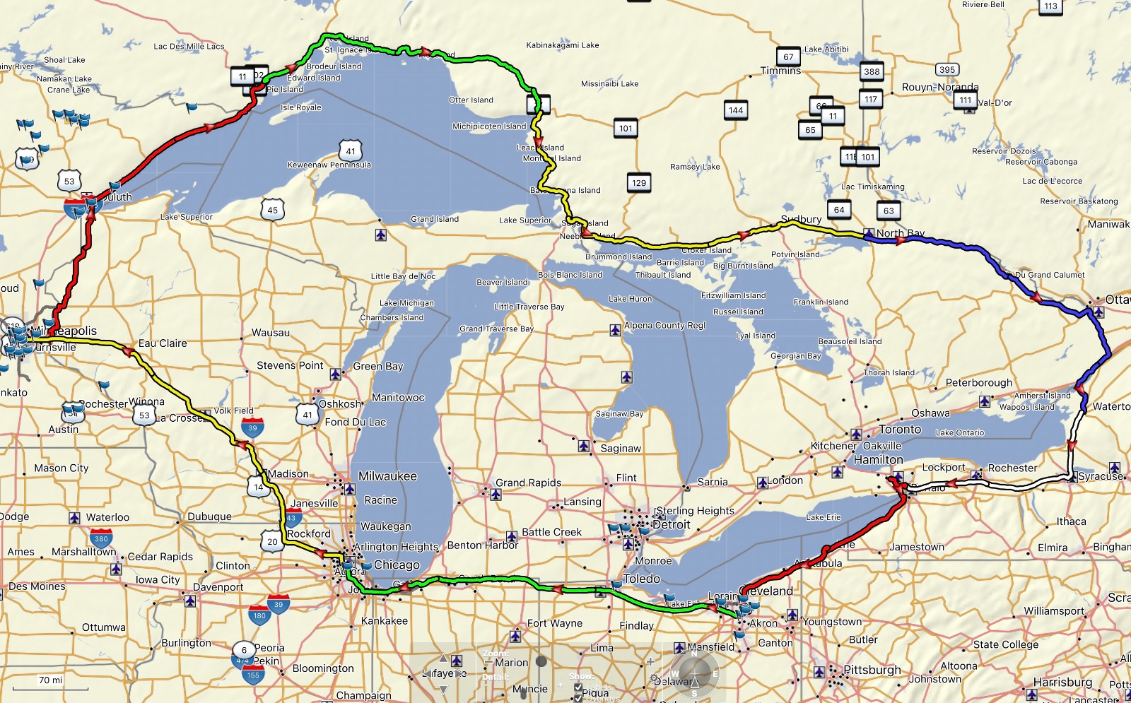

I just got back from a 2700+ mile trip (I went around all of the Great Lakes - what a fun ride!) where the Zumo, shockingly, never once rebooted or froze up. I'm happy for that.
Now that I'm sitting at my desk at home, I want to download the tracks so I can have a little map of "where I've been this past week" and ... while it's always been a frustrating process to get it to connect, now it absolutely will NOT no matter what I do.

Basecamp finally worked by doing the ridiculous:
1. Back up Basecamp config (just in case)
2. Delete the (fully-up-to-date) Basecamp application
3. Reinstall Basecamp
4. Run Basecamp - notice spinny beachball for a minute and a half, and then it starts populating with data from the Zumo XT
What a pile of horse-crap this is. If only there was some other way.

Mostly all I use Basecamp for now is to pull the tracks after a long trip.
I wanted to map out my 8-day trip in an overview, and there's no easy way I know of to pull that data with any other software.
