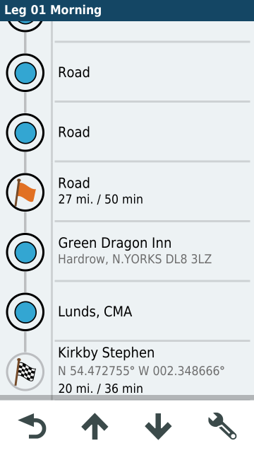

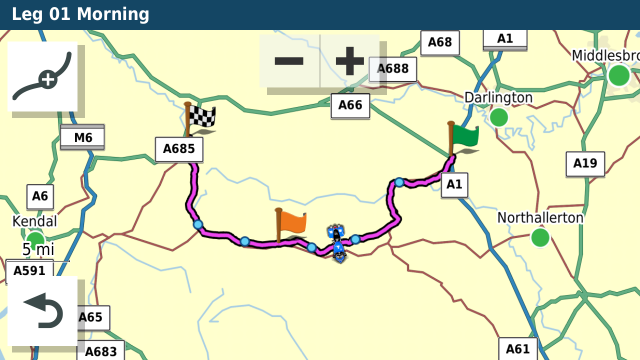

There is one thing that you can do with the 590, 595 and XT. Take a look at the zoomed out map - tap the caption bar at the top, then the map symbol in the top left corner. This shows the route with your position and the shaping and Via Points plotted.
Then show the trip list for the active route. You can see the shaping points ahead. Find one that you want to navigate to next - assuming that you have to detour. I'm going to miss out the next shaping point, and head for the one after that. So that is the third one from the end.
So the one I want to head for is the one above the Green Dragon Inn.

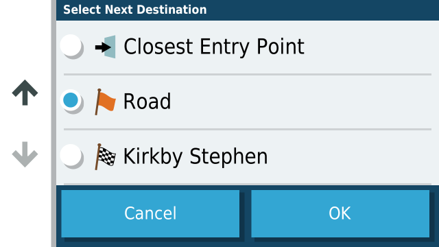

Tap it. The route will recalculate.

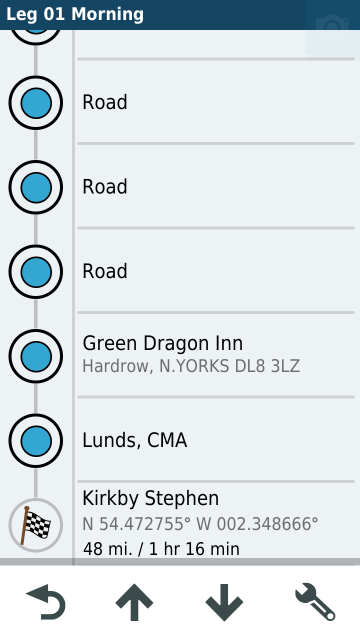

But it has converted that shaping point into a Via. (it is safe to do it this way. It is not safe to convert it back to a shaping point - it will relocate it.
Note that this has now edited the route that was imported. You don't give it permissiont o do this, but it has now changed. If you stop the route and reload it, the new Via point will be in the re-loaded route. You could delete it and reimport it from the transferred routes that may still be in temp.gpx - that will be the original - but Basecamp overwrites temp.gpx every time a new USB connection is made and files are transferred. On the XT check it is there to import before you delete it.

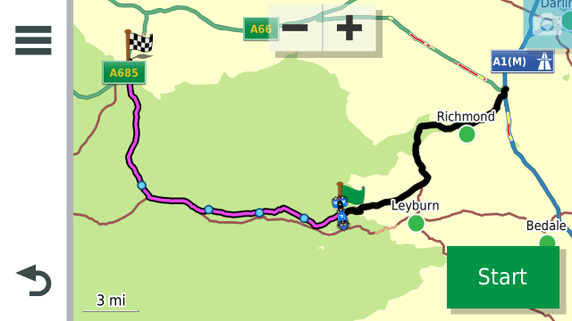

Now stop the route, load it again from Trip Planner and when you say Go, the new Via Point will be there to select as the next destination.
Its a bit long winded, and entirely unnecessary in this example but on a long route where the detour which may involve going around a mountain rather than over it, having the satnav take you to the other side in the way that it sees best could be useful. The idea is simple. You are making an existing shaping point into a Via point so that you can restart the route and select that Via Point as the next destination. The satnav ignores the route before it and just takes you to that, and continues with the route from there onwards.
