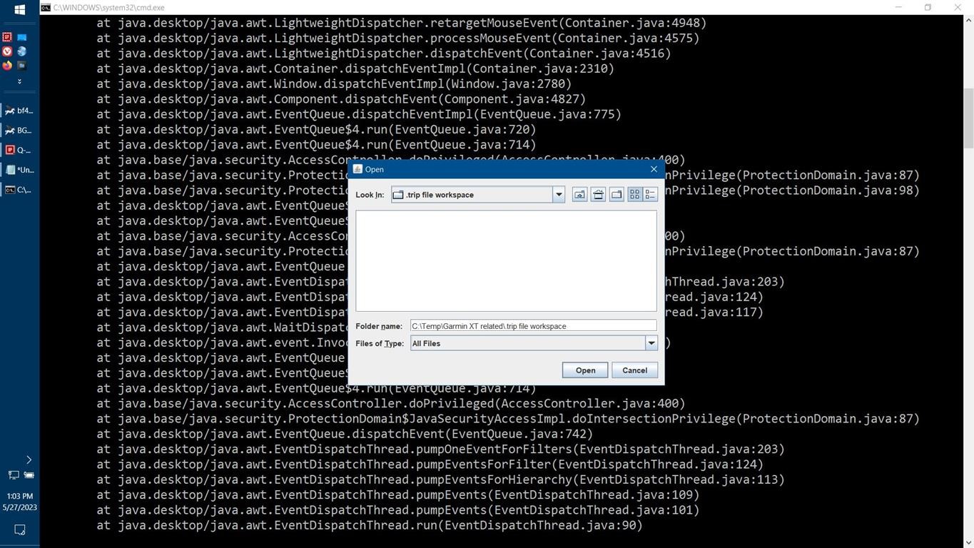

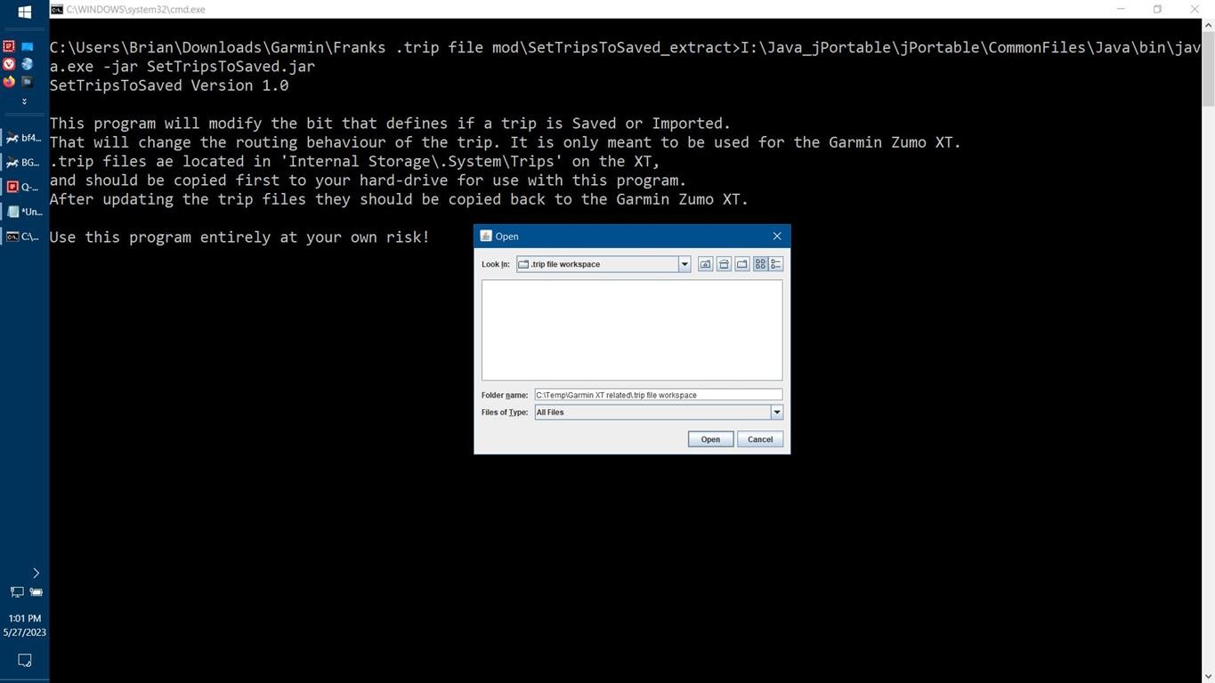

jPortable downloads a functioning version of JRE (182 MB). I placed it on a flash drive and ran SetTripsToSaved on it. It worked, but its "Open" window (its directory structure navigation window) is noticeably smaller than when run with JDK, almost too small for my old eyes.
My only other comment is that it would be nice if the .trip files were displayed in the "Open" window.

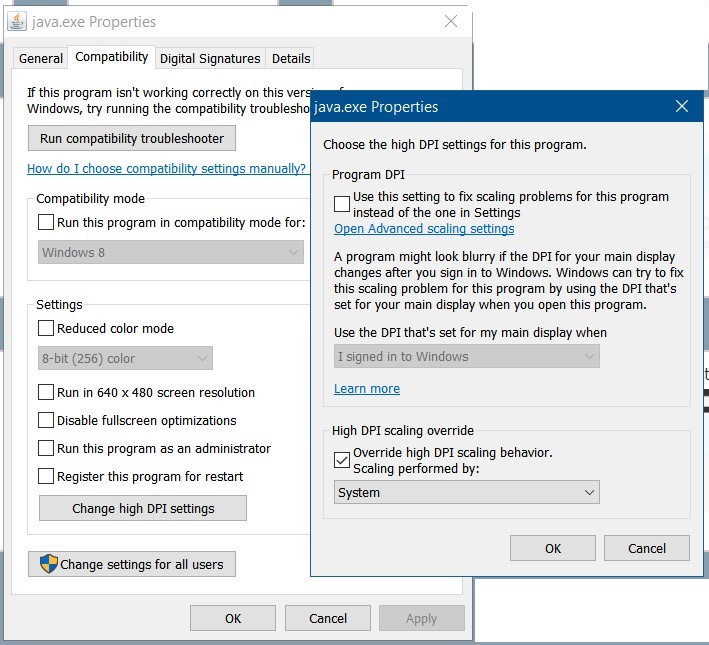

One more edit: The window size issue is associated with DPI. It can be significantly improved by adjusting a high DPI setting for java.exe to override high DPI scaling behavior.
FWIW, I run my 1920x1280 laptop at 125% scaling.

When Frank's program is run it simply pops up a file chooser dialog in which you select the folder that contains the original .trip files and it modifies them. It does not display the .trip files in the file chooser dialog nor do you have the option to keep the originals and produce modified files with a different name. It works fine once you understand it. If you need help getting it to run then I suggest pushing the "Easy" button and using the online tool. https://www.zumouserforums.co.uk/viewtopic.php?t=2323
