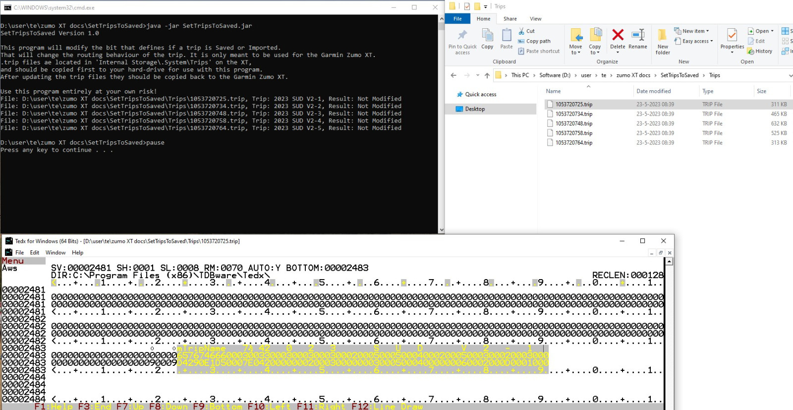

The tripname can be found in the .trip file. My experience is that it can be found at the bottom of the file.
In the bottom half of the screenshot you can see the 'mTripname' keyword followed by the name. Each character takes 4 bytes. I guess it's UTF32
In the upper right part you see how Windows Explorer displays it, and in the upper left part you see the output of the Java program, that displays 1) the file name, 2) the trip name and 3) If it's modified.
(And this is not an effort to persuade you to use the Java program!)

@FrankB, I should have anticipated that you would include the trip name as a connection between the .trip file and its trip. Nice touch!
(And now I might have to install Java just to check it out.)

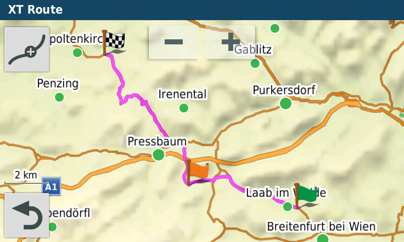

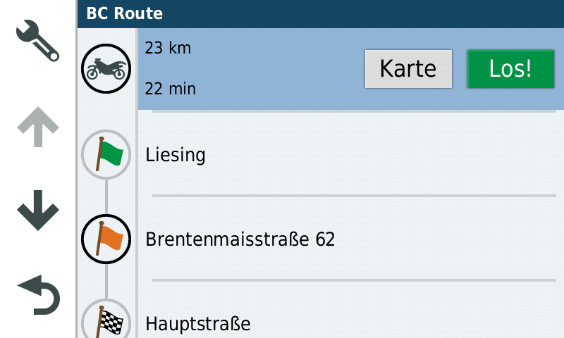

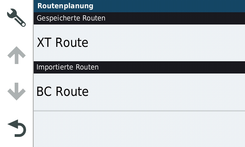

Did check, where the files are stored - 'BC Route' is in 'GPX/temp.gpx' and 'GPX/current.gpx' and 'XT Route' is only in 'GPX/current.gpx'. I add both files, if it is helpfully for you. Also here are the screenshots from the two routes:
Here we go - as expected, 'BC Route' is listed under 'Imported Routes' and 'XT Route' is listed under 'Saved Routes'. Named the routes just as suggested from you, two nearly identical, short routes with one via-point in the middle, 'XT Route' was created directly on the Zumo 595 with the route planning tool and 'BC Route' was made with Basecamp and transferred via drag-n-drop to 'Internal Memory' - after a restart of the Zumo 595, it asks if i want import a new found route to the route planning app, and i said yes...jfheath wrote: ↑23 May 2023 16:47Oh thanks !
Have at lease one route created using trip planner on the 595. Call it something imaginative like "XT Route".
Have at least one route on the 595 that has been transferred from Basecamp, and has then been imported. Call it "BC Route".
Select Apps->Trip Planner->Saved Trips. The XT shows a couple of black 'headers' across the list. One above the 'Saved Trips' and another above 'Imported Trips' Scroll down to see what the 595 has please. Where are XT Route and BC Route located in the list ? Under what Banners ?

Wow - thank you. So yes the 595 does make the distinction, just like the XT. But the 595 never had the RUT issue** - but neither does it have the ability to turn tracks into navigable 'trips'. WHich I think is significant. I think that imported is
