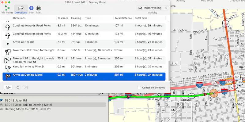

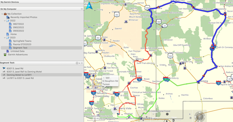

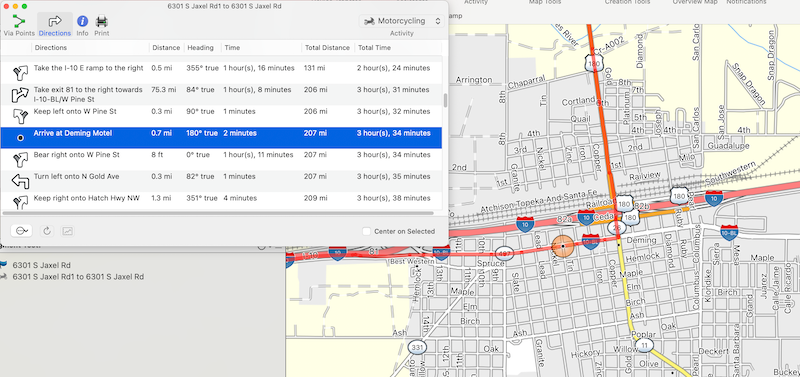

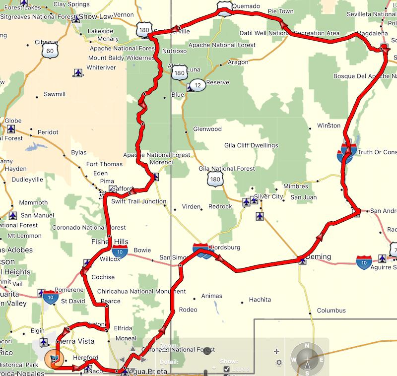

Okay so I am kind of answering my own question for route splitting but I thought others may be interested. I forgot about the ability to view the route distance in the directions tab on the route info box. You can't see the distance unless you expand the box. You can scroll down thru each point and see a highlighted circle on screen. once you find the desired stop/break point go to the Via Point tab and right click on the point where you want to break the route and select Split Route Here. This creates a second route with a new name.. See screen shots that I did for a mock up.
Overall Route approximately 865 miles
