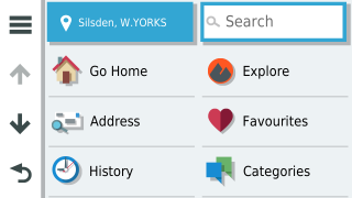

Yes, it does.
The option appears in a number of screens, but it is cunningly disguised and invites you not to press it !
Example given in landscape view
Where To ?
Where To.jpg (28.62 KiB) Viewed 2319 times
The search box appears top right and takes up half of the width of the screen - above the display of the first six option - Go Home, Explore, Address, Favourites etc. Yours may look different because you can drag these items around so that the ones that you use the most appear on the first screen.
But unseen to the left of the search box is a blue rectangle that appears to be telling you where you are. It isn't. It is telling you where it is searching. Tap it.

Do this before entering your search or category. The search area remains while the blue rectangle shows what you have selected.
The blue rectangle reverts to your current location when you go back to the Where To ? screen. Searching near your current position seems to be the default setting.
The same feature appears on other screens, but the blue rectangle is sometimes replaced by a smaller blue button with a tear drop icon - eg when using the FourSquare database, or here in Favourites.

Thanks John for that detailed explanation. I never realized that the blue box to the left of the Search box was clickable or that I could search by category like that. Every day is a school day!
Is there a way to change the order of the categories? Long hold > drag does not work on that screen.

Peobody wrote: Thu Jan 05, 2023 3:21 pm Thanks John for that detailed explanation. I never realized that the blue box to the left of the Search box was clickable or that I could search by category like that.
It was your question that prompted the explanation. I wouldn't have remembered otherwise - it's not something that I use a great deal. I knew that it hadn't been obvious to me, so it probably wasn't obvious to some other people too.
For some reason I knew that it was possible long before I discovered how to do it. That blue box is weird. I genuine 'Sorry Mate I did Not See You' type of box. It is there all the time, but it looks as though it does nothing - so your brain ignores it.
The little tear drop icon on some subsequent searches does the same thing, without dispalying any text. So you can select or modify where to search AFTER you have started searching for (say) a restaurant.
