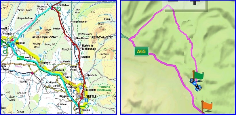

The problem:
Weird Side by Side.jpg (93.87 KiB) Viewed 3384 times
The left hand picture shows the route that The XT want to take me - from Ribblehead to Settle - Via Ingleton. B6255 and A65.
The red route shows the direction that I intend to ride. So I deviate just after Ribblehead - and turn south - the B6479.
The right hand picture shows what the XT is trying to do - the bike and the green flag are approaching settle (heading south). It is insiting on taking me back to Ribblehead, turn left and then along the A65. It has been doing this, telling me to U-Turn ever since I turned south at Ribblehead.
The only route point of concern is a Via Point to the south of Settle. There are no other route points.

Regarding the Route from Hawes to the A65 south of Settle as shown in the maps above (and post#1) Hawes isn't shown on the map - it is about 8 miles NE along the road that disappears off the top centre of the displayed map.
The calculated route takes the B6255 SW to Ingleton before turning SE on the A65.
I choose to turn left at Ribblehead and take the B6479 SSE to joint the A65 South of Settle.
Both routes pass throught the same route points and there are no other route points involved.
When I deviate from the plotted route by turning left at Ribblehead, the XT repeatedly demands that I turn back to the junction and follow the plotted route, forvever - until I have got to within 2-3 miles of where the two routes meet again.
The same thing happens if I place a shaping point just after the start, and just before the end.
The same thing happens no matter which software I use to create the route.
It happens whether the XT has calculated the route or whether it has initially been calculated by Basecamp.

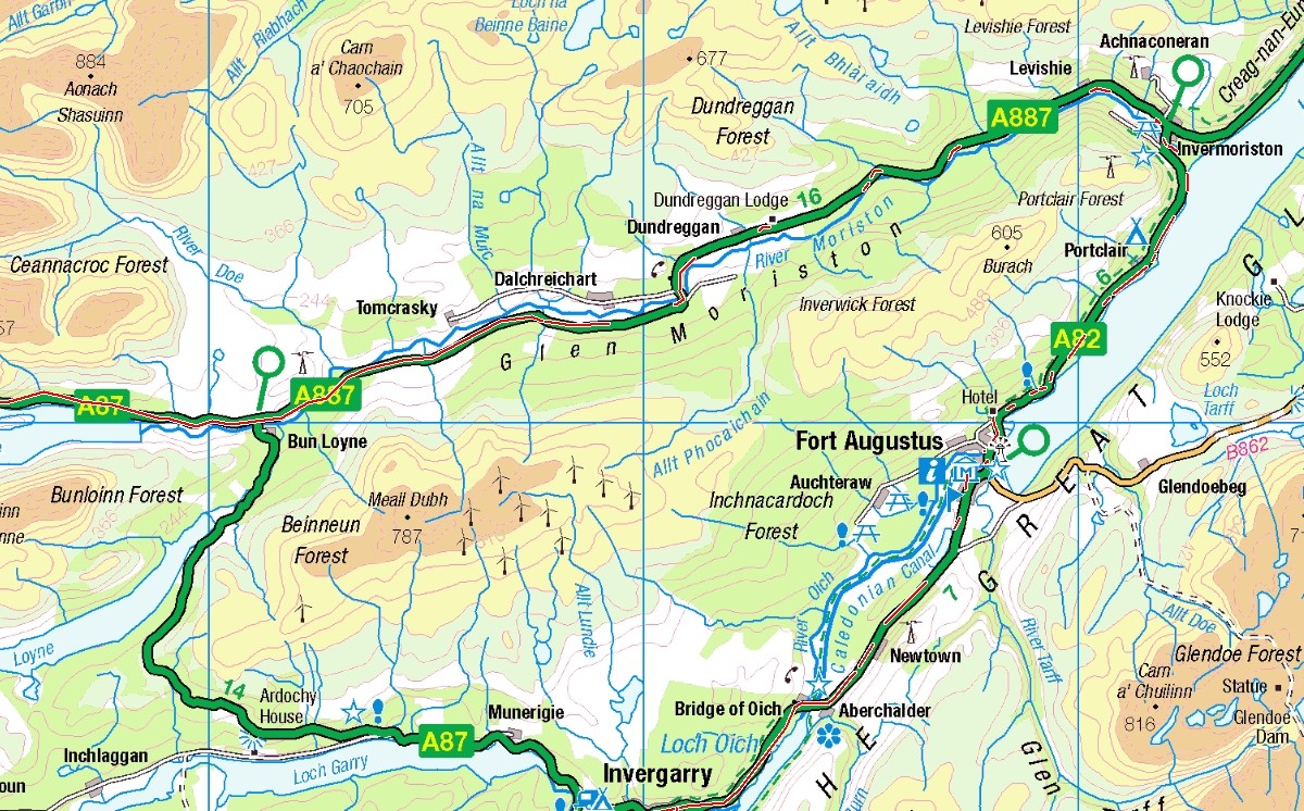

I had noticed a number of times that whenever I get into this cycle of repeatedly asking me to perform a U turn, the tracklog is broken.
Here is an example taken from our recent tour of Scotland. We were heading to Skye from the south. The planned route was to take the A87 from Invergarry - it is a much more interesting route, but we needed fuel, so instead I went to Fort Augustus filled up and then continued NE to the A887 and joined the original route ta BunLoyne. From Fort Augustus, the distance to Bun Loyne is 20 miles if I go back to Invergarry and take the original route along the A87. It is 21 miles if I head NE and take the A887 from Invermoriston. SO initially, the satnav is correct in routing me back to Invergarry - but it should adjust as I head towards Invergarry. It doesn't give up demanding a U turn until 4.5 miles from BunLoyn junction.
Click the image to zoom in to see the red broken track log superimposed on this OS OpenData 1:250,000 map
1:250,000 Open Data Ordnance Survey Maps are free to use in this way providing the following acknowledgement is given:
Contains OS data © Crown copyright 2020
Broken TrackLog.jpg (396.24 KiB) Viewed 3182 times
I have observed this a number of times, but I sent a couple of examples to Tech support, and described the circumstances.

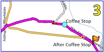

Two More tests. This time the first of series of 4. A short, 3 point route: Start -> MidPoint -> End
Between A and C there is a shorter, faster By-Pass of a small village. The Midpoint is plotted in the small village, but when travellng, I take the By-Pass to see what happens.

This is the wrong image. I deleted the original by mistake when editing this post. This shows a similar test ont he same road A would be off the picture on the left. The coffee stop would be the mid point. C would be a point a couple of miles off to the right.
I'll replace it witht he correct one when I get the chance.

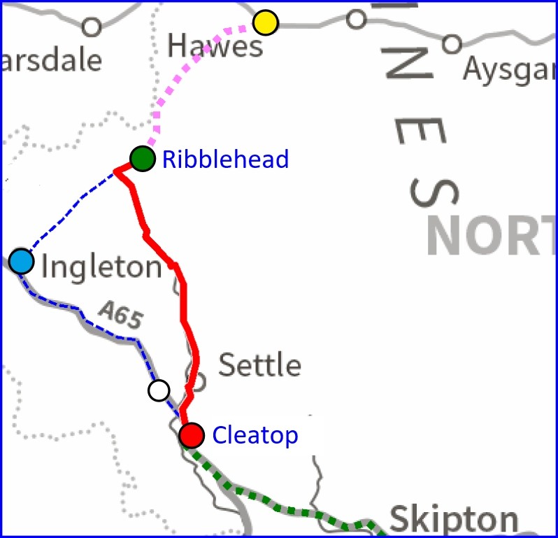

This is the same route that I used when I started this thread. I've used this course a number of times because it demonstrates two issues very clearly. One is the repeatedly trying to get me to go back to the point at which I deviated from the XT's route. The other is the apparent connection between the broken track log and the places where the U turn / route recalculations occur.
Route Map.jpg (72.05 KiB) Viewed 3035 times
Click the image to get a larger view.
The solid red line shows the route that I intend to take.
The Blue dashed line is the route that the XT calculates between Ribblehead and Cleatop - it goes Via Ingleton.
The Pink dotted line is the longer route from Hawes - which I use in test2 for testing the behaviour of Closest Entry Point
The green dotted route is the calculated route when I introduced Skipton as the End Point (test 4 and 5).
Ribblehead - the start - is marked with a green circle.
The bike will start about a mile to the east so that I pass through Ribblehead once I have started riding
The End Point for most of the testing is Cleatop - the red circle on the map.
Hawes is marked with a Yellow Circle - only relevant for Test 2.
The white circle shows where the Cleatop route point was moved when it was changed to a shaping point.
This test is not about faster routes. It is about the XTs ability to come up with a new route after I opt to travel along a different road.
I created exactly the same route from Hawes to Cleatop South of Settle as I have used in earlier tests, although I save time and petrol by starting not at Hawes, but about a mile East of Ribblehead.
The XT calculated the route exaclty as before - creating the route that is marked by the blue line on the map. According to the XT, this route is approximately 1 minute faster than my route. But which is faster is not the issue here.
I intended to turn left at the road junctio just after Ribblehead, and head south twowads Settle and Cleatop.
There were slight differences in the test each time on previous occasions. I am trying to to tease out what makes the routing go wrong.
I had already established that when sitting at Hawes, if I asked the XT to navigate me to Cleatop with no saved route - it would initially plot the same route, but would INSTANTLY recalculate if I turned left at the junction after Ribblehead instead of going straight on.
So tTest 0 was to establish if it would do the same if I set off from just before Ribblehead, rather than setting off at Hawes.
All of the routes were created on the XT using previously stored Favourites. The routes were recalculated before each test. U turns were allowed. No extra maps on the XT and the SD card was removed - except for test 5 when I put it back in.
04 November 2022 Broken Track Test 0 wrote:No Route - Where To - Cleatop
I did not prepare a route for this, I just asked the XT to navigate me from my current position East of Ribblehead to Cleatop. It wanted me to continue straight on at the junction. I turned left. It Instantly calculated a new route along the road that I wanted to take. There was no break in the track log. No U turn requests. This is how it should be.
04 November 2022 Broken Track Test 1 wrote:Route from Ribblehead to Cleatop
The Start Via Point was at Ribblehead. I was a mile to the East. The End was at Cleatop. No intermediate route points.
I set of, and passed throught he start point. The magenta line wanted to go straight ahead. I went left. The route recalculated instantly to follow the road that I was taking. No U turns requested.
04 November 2022 Broken Track Test 2 wrote:Route from Hawes to Cleatop - Closest Entry Point
I was conscious that my route was shorter than the original from Hawes. For this test I created a new route from Hawes to Cleatop. It passed through my current position and went ahead at the junction as before. I turned left as before.
This time, the route wanted me to turn back to the junction. I kept going for 3 miles and in that time it made 6 demands for me to U turn. I have seen this behaviour before, and was not going to ride any further. It was stuck in a loop trying to get me to go back to the last point that it asked me to do a U turn.
I stopped the route and checked which way the XT would take me to get to Cleatop from here. It chose the route that I was taking.
Inspection of the logs afterwards revealed that the track log was fragmented with a gap which corresponded to the places wher it has recalculated the route and asked me to perform a U turn. My heart sank. It was still doing it. Never mind, continue with the tests.
04 November 2022 Broken Track Test 3 wrote: Ribblehead to Cleatop Via Point to Skipton End
For this test I created a new end point at Skipton - 13 miles SE down the A65. Cleatop remained ont he route as a Via Point. This is because I have previously noticed that routes sometimes behave slightly differently if there is a mid-point as opposed to a start to finish route. I wanted to see what happened in this case.
So the route is now Ribblehead START - Cleatop VIA - Skipton END
After setting off and passing through the Ribblehead Start Point, I again ignored the plotted route and turned left taking the direct route to Settle and Cleatop. The XT recalculated the route immediately taking me in the direction that I was heading. The track log broke at this point.
04 November 2022 Broken Track Test 4 wrote:Ribblehead to Cleatop Shaping Point to Skipton End
This test is identical to Test 3 -except that I used the XT screen to change the Via Point at Cleatop to a Shaping Point. Now we know that this causes the point to be relocated slightly and for it to be renamed. But the effect of this was more significant than I expected.
The XT's route was the same as before - straight ahead to Ingleton, but I turned left at the junction after Ribblehead. This time the XT wanted me to perform a U turn, so I kept riding towards Settle. I got two more requests to U turn and go back and had given up hope when it decided to calculate a new route in the direction that I was going. So that was OK. But why the difference between the Via and Shaping Points.
Tre track log revealed a number of broken track segements, each break corresponding to the recalculation and demaned to perform a U-Turn.
04 November 2022 Broken Track Test 5 wrote:Repeat Test 4 with SD Card replaced
This test is identical to Test 4 - except thsi time I would be riding all the way back home. And before I set off, I turned off the XT and reinserted the SD Card. Technical Support had asked me to remove OSM maps and the SD card to see if that made a difference. So far not, but I would need to reinstall OSM maps and repeat these tests and get the same results before I could be certain.
So with SD Card in place, I set off and turned left again - and obtained exaclty the same results - a number fo U turn requests and then calculating ahead. This is what I would expect it to be. But it doesn't explain the difference between the Via Point and Shaping Point.
Again track log was broken in places which seemed to correspond with the recalculation of the route and the U turn command.
After Settle, I did not take the dotted green line route to Skipton. I detoured wildly first south then east on much nicer roads. These detours were also treated sensibly. There were noww side roads to get me back to the A65, which it wanted me to take. But as I progressed, this route became faster than any other offferings - and it continued to navigate ahead presumably using my current position and the next route point.
This is a mjor success, and the first time that this has happened along any of this route in 2 and a half years and 2 different XTs. Something has definitely changed, and it is definitely for the better.
The reason why the XT made 3 demands for me to U-turn before navigating me along my route ?
Cleatop had been deliberately chosen as a Via Point point because it was on the A65 AFTER a roundabout where my preferred route joined the XT's 'faster' route. In other words, both routes would pass through it.
When I changed it to a Shaping Point the XT moved it so that this was no longer the case. It was now 3 miles away from its original location and positioned on the A65 3 miles NW of its original location. I have shown it as a white circle on the map. On my route I would have to make a detour in order to get to it - so it took longer for the XT to believe that my route was faster.
NEVER use the XT to change a Via Point to a Shaping Point. It always seems to move the shaping point onto what the XT considers to be the faster route - forcing you away fromt he route that you had intended.
