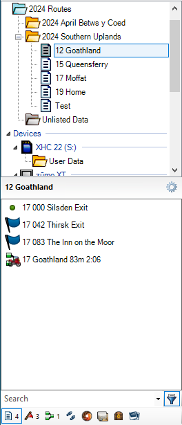

In the partial screen shot of Basecamp below. I have a database - mine is called 2024 Routes. AT present I have two (yellow) list folders:
* 2024 April Betws Y Coed. There is nothing in that as yet.
* 2024 Southern Uplands
2024 Southern Uplands contains 5 Lists - which I have numbered according to the day of my tour.
12 Goathland is the list that is currently selected, and its details are shown in the lower pane - 3 saved Waypoints (created with the flag tool in Basecamp). These will end up in Favourites / Saved on the Zumo. And a single route. I normally plan a couple of alternatives in case the weather is particularly good or desperately bad !!
BY clicking on a single list folder, I can see the routes, tracks, route points and waypoints for just a single day.
By clicking on 2024 Southern Upland, I can see on the map all of the routes for the whole tour.
By clicking on 2024 Routes, I can see everything that I want to see in the database.
The tiny icons at the bottom allow me to filter what I can see - eg Just the waypoints, just the routes, just the tracks

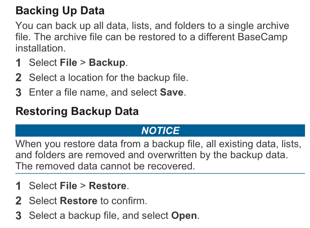

Point 1 above, backing up the DB for BC would be good to know. Is it fairly easy to do?
Re: Shaping points converting to way points
oldwobbler wrote: Sat Mar 23, 2024 7:49 am Point 1 above, backing up the DB for BC would be good to know. Is it fairly easy to do?
This is taken from the Basecamp manual. Let me know if you need to see it in action.
