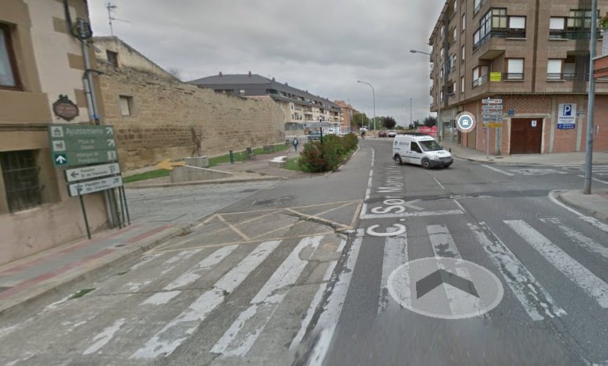

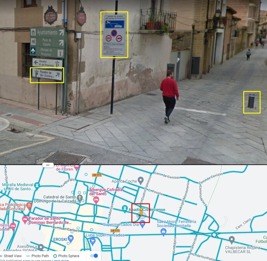

Sorry - Google Street View. Preparation before even putting the route onto the XT. I find the places in Google. Click on Maps. Sometimes use the satellite view to find car parks. But place the yellow figure on the road and 'drive' along the road to see the junctions.
In unkown places in unknown countries you don't know what you are going to be presented with, so I always check.
A good example of this - in Northern Spain (about 70 miles south of the ferris on the northern coast) finding one of our favourite hotels - at Santo Dominigo de la Calzada. The hotel is in an old city. Cars / motorcycles are not allowed - except to to get to the hotel. You have to ride very slowly along sometimes very narrow streets and you are allowed to park for 10 minutes while you go to the reception to ask them for access to their underground car park. The entrance to the city is not obvious, and I see that it is now controlled by radar detection. It used to be a push button and intercom system.
So it was really helpful if you have already translated the road sign, that you know to press the button, and that you have your best Google translate phrase ready to say. "Hola, ¿hablas inglés, por favor? Estamos al hotel parador. Estamos en una moto." Which hopefully gets you through without having to understand any reply - even if you could hear it without removing your helmet and stooping down to car window height.
In addition - spotting the road signs directing you to the hotel is a bit like playing 'Where's Wally' (Where's Waldo in america, I believe). There is one way in and the chances are you have to go round the circular road surrounding the city. Usually twice before you get your eye in and spot the very insignificant side road. The road signs are very helpful - except for the fact that there are 2 Parador hotels, and the signs don't indicate which one you are heading for !
Parador 2.jpg (89.33 KiB) Viewed 1123 times
The entrance is on the left just after the crossing. Very easy to miss.
So in this situation I would put in the location of the hotel, and add shaping point to take me to the only entrance to the town, and to keep me on the side of the road where I can turn without crossing traffic. Anything to make life easier on a sweltering sunny day, on the first day of a long ride riding on the - wrong for us - right hand side of the road and getting used to Spanish driving habits.
