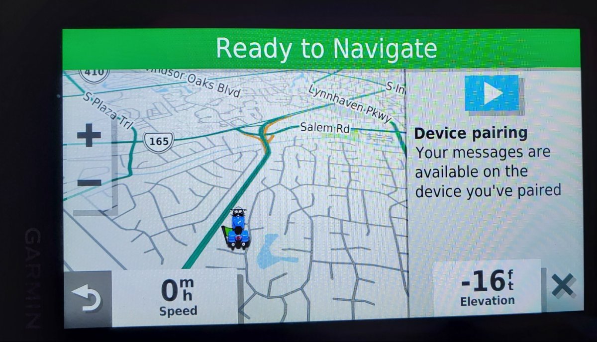

I am getting the notification saying my device is paired. This continues every ten minutes! Any idea how to turn this notification off? Phone is Note 10+. I had these problems before, but then I got Android 12 shortly after receiving the XT.

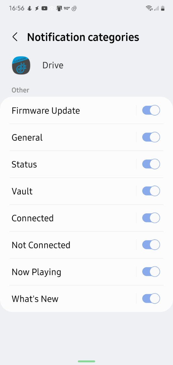

Does anyone know what each of the notification categories do in the app.

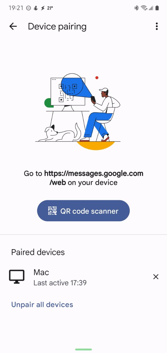

Figured it out!!
Post by MotoToph »

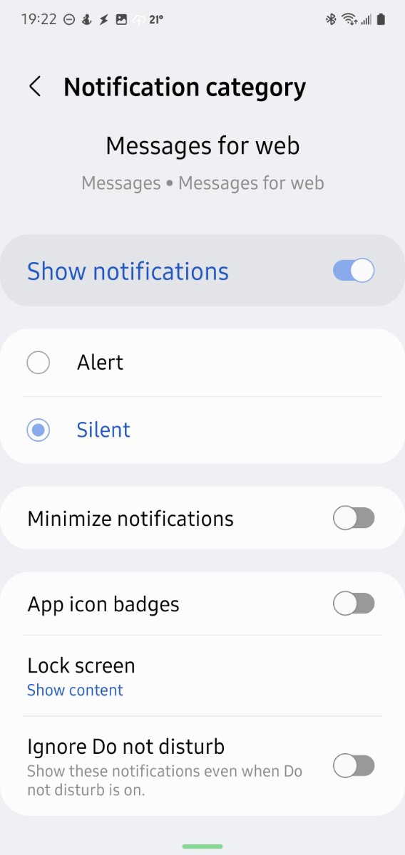

Ok I figured it out! That device pairing message was Google Messenger(Chat) saying that I was paired to another device. It was paired to messenger for Web. I had it set for silent notifications on the phone, but they still came through the Zumo. Every 5 frekin minutes! It was so long ago that Ive been connected to chat for Web that I forgot about that annoying notification. I turned notifications totally off for that. Phew!

Cgltd wrote: Tue Apr 26, 2022 9:01 pmDoes anyone know what each of the notification categories do in the app.
