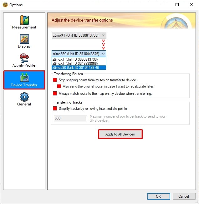

My Zumo XT was replaced under warranty recently. I hadn't noticed that in one area of the Basecamp configuration, the settings that I have made do not necessarily apply to the attached device. They apply only to the device(s) that are selected. Since Basecamp lists both of my devices - I hadn't spotted that it was my old Zumo XT for which I was changing the settings.
The settings concerned are here:
Edit -> Options -> Device Transfer -- Click the image to view a full size version.
These settings affect every single transfer that is made via the USB cable. Unless you specifically want to set them otherwise, I recommend that none of the check boxes are ticked. I believe that this is not the case by default.
A safe way of dealing with this is to press the button labelled 'Apply to All Devices'.
In my case, I simply hadn't noticed that the display above was showing my old Zumo XT. The changes that I made were having no effect when I transferred routes to my New Zumo XT.
You can check the device Unit ID from the Zumo Screen:- Settings->Device->About
or from within Basecamp with the Zumo connected Device->Device Information->scroll left or right .
