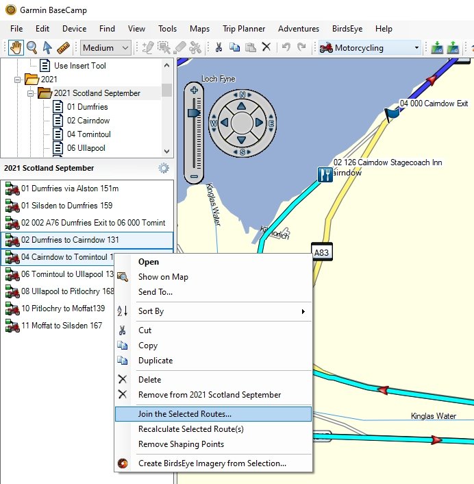

Yes, the correct EU map is loaded. When I select the various sections of the route in the panel on the left side of the screen, the corresponding sections of the map are highlighted. That being done if I right click on that same list of now highlighted sections - there is no “join” …
Today I am going to send a .gpx file from my iMac to my PC to see if the menu on the PC has a “join” …

Select the image to see a better quality.
CTRL-Left Click selects two routes that are not adjacent in the lower left pane.

I just tried that on my iMac..the menu is different, there is no “join” command..I sent you a screen grab by email.

I have screenshots of Mac menus. (That's as close as I get to getting my hands on one !)
There is a Join Track, but no Join Route.
Unless there is a contextual menu pop up.
I've had a PM from Bob.
The only other way it to copy the route points from one Trip list onto the end of another.
Not neat, but easy enought to do. (I've done it a lot of times, I never noticed the Join option for years !).

In Windows it shows the relevant one, so join tracks or join routes depending on what is selected. Sounds like Mac doesn't do that.
