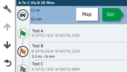

Ok - I have taken your original gpx file and transferred it to Basecamp and from there to the Zumo XT.
Since BC created all points as Waypoints, they are no available for me to use to create routes from scratch on the XT, using the trip Planner App - so when adding the start, I just scrooled to favourites and picked up your Point A. Since I am 200 miles further north, this made it a lot easier.
I have screen shots of two of these - the ones that routed you via Petersfield. No problem whatsoever. The Zumo created the route and preview map is available to view. (This feature may need to be turned on in Settings->Driver Assistance->Route Preview).
It is those screen shots that I have reproduced below.
First the route with the start and end points and the Test B Via Point

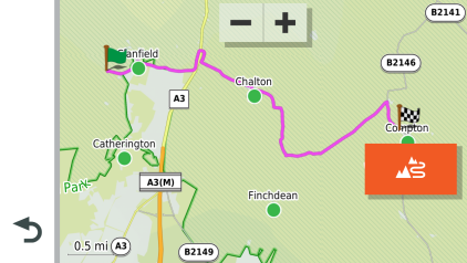

A second route made in the same way, going from B to C
So that works perfectly well on my device.

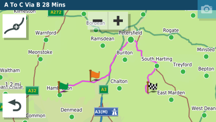

Now looking at what happens when I load in the routes from your gpx file.
And the map that can be displayed
Aha - it is wrong, isn't it ?
No - that is perfectly correct. Assuming that the XT hasn't recalculated the entire route when it was transferred then the XT will reproduce exactly the route that was sent to it from BaseCamp. No calculation is required and usually no calculation is even attempted.

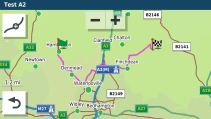

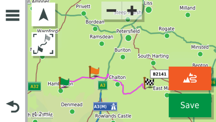

Thanks for all that, certainly helps confirm my understanding of how this works.
On my device I created a new route using a,b and c . No bc involved at all, device not connected to PC. It creates the route wrong via Petersfield. Yours creates the correct route. I would love to understand why.
My maps are 2022.10 and software is 6.2
Any idea?
Any idea?

Right - we are making progress.
It has to be something different in the settings between mine and yours.
Motorcycle, faster time. I have no avoidances set - except unpaved roads.
Try this. Settings->Navigation->Tolls and Fees. Set it to Allow.
Then load up your B to C route. It will probably tell you the settings have changed. Yes - recalculate it.
Mine will go to Petersfield if I dont allow tolls.
It goes direct if I do allow tolls.
(But that doesn't explain why your A to C route worked OK ! )
Try it anyway - it has to be something like this.

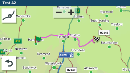

So yes if I allow all tolls it routes it correctly!!
So this is bizarre and raises 2 questions
1. there are no tolls anywhere in that area that I know of.
2. Why does A to C work irrespective of the tolls setting.
The fact that A to c works makes me think its not a map issue.

Well I wouldn't report it to them yet at all. We don't know the reason for it doing it - nad it could still be a mapping error.
I have just tried a route from A to C on the XT, and it too re-routes if tolls are set to Avoid. So it is consistent in avoiding a certain section of the direct route between A and C.
That suggests that something along that route is marked as a toll road.
To find that needs a lot of testing - Moving on of the points in to halve the distance. And test.
Depending on the results move A or C In or out by half the distance and see what happens.
Eventually you get to pin point the section of road that is marked as a toll.
And if that turns out to be the answere - then that is a map fault that is reported to another site. A precise statement.
This section of road is incorrectly marked as having a toll. Give the name of the road and give lat an long - or a gpx track identifying the scetcion. No opinions, no argument - just a fact that they can test, duplicate and get it fixed.
If you cant find a culprit, then its back to the point we are at now and come up with another idea.

Yes - it certainly changes. Previously I had said that it went direct - but at that point I hadn't fiddled with Toll road settings. Min is always set to allow.
When I did fiddle, it changed route. But I doub;e checked as requested. I got the same two routes, but reveresed from what I remember. This is what I get now. (note the detour south is what I got last night for A to C - when B-C headed to Pertersfield - that isn't new behaviour.
Avoiding Toll Roads:
Allowing Toll Roads
Now I mayhave made a mistake last night, I don't think so, but it was late, so I may have done.
It is making me wonder if the date issue and historic traffic flow is coming into play. To check that, I'd need to reset my XT, and that would lose my active logs, which - having just had a long tour - I don't want to do until I have downloaded them and transferred to my mapping program.
There is more to this than meets the eye. I'll revisit that previous test tonight - but it night need to be next Sunday night to test properly.
Today, I discovered something really important. I found another way that doesn't work.
