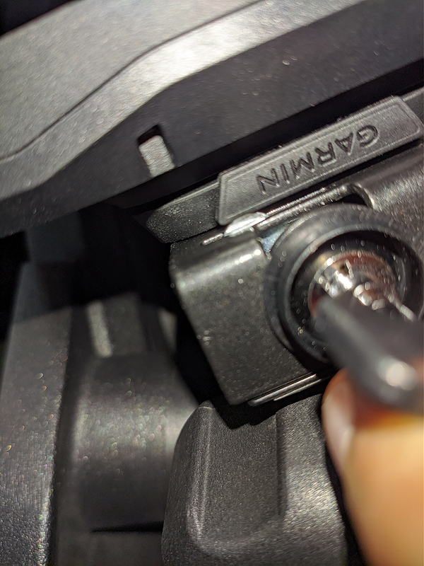

Just received the Zumolock XT and followed the installation instructions on the box (which are very simple).
But it seems not to be working as it should. The little metal tip of the lock his hitting the catch release mechanism.
I’m afraid to put some force in the lock as I could damage the catch release mechanism of the mount.
Is there any recommendation or anything I'm doing wrong?
I bit disappointed, I know it's not the most expensive lock but surely not cheap either.

Loosen the bolts and try lifting the mount up and also make sure that the zumo is pushed all the way home
Thats all I can think of

I've already pushed the lock down when tightening those screws as it was hitting the catch if not.
No problems when locking/unlocking with the GPS off the mount, but when it's mounted (and I believe it's well mounted as I ear the click of the catch mechanism) the lock will hit the catch like that.
I might try to warp down the metal tip of the lock but I would like to know if I'm doing something wrong here... Seems not.
I've mailed Zumolock with the problem let's see if they have any better idea... not happy.
Thanks.
Thanks.

I'd try loosening off the bolts, install the XT in the mount, lock up the zumolock, tighten up the bolts. IIRC this is what I had to do with mine.

And that did the trick!Oop North John wrote: Sat Jul 10, 2021 6:01 pm I'd try loosening off the bolts, install the XT in the mount, lock up the zumolock, tighten up the bolts. IIRC this is what I had to do with mine.
Although a did press the lock down when tightening I did had the XT off the mount that wasn't enough to have the right alignment.
Doing as you did just move 1mm down the metal tip which is now enough to lock up the zumolock with the XT on the mount.
Thank you very much for your help!
