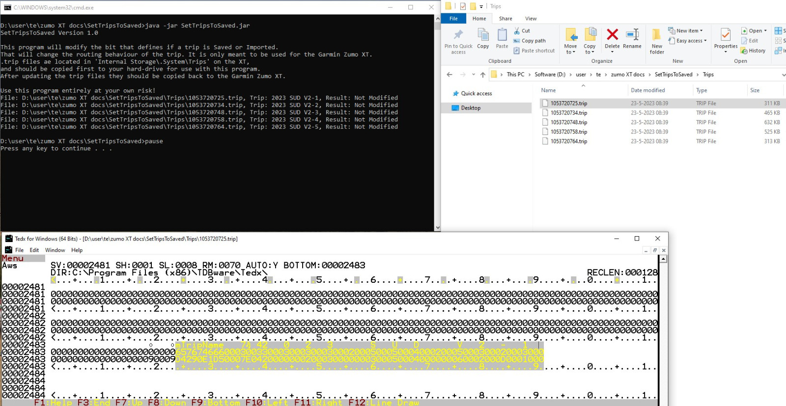

Peobody wrote: Tue May 23, 2023 8:51 pm since there is no way to identify the trip associated with a .trip file from the .trip file itself?
The tripname can be found in the .trip file. My experience is that it can be found at the bottom of the file.
In the bottom half of the screenshot you can see the 'mTripname' keyword followed by the name. Each character takes 4 bytes. I guess it's UTF32
In the upper right part you see how Windows Explorer displays it, and in the upper left part you see the output of the Java program, that displays 1) the file name, 2) the trip name and 3) If it's modified.
(And this is not an effort to persuade you to use the Java program!)

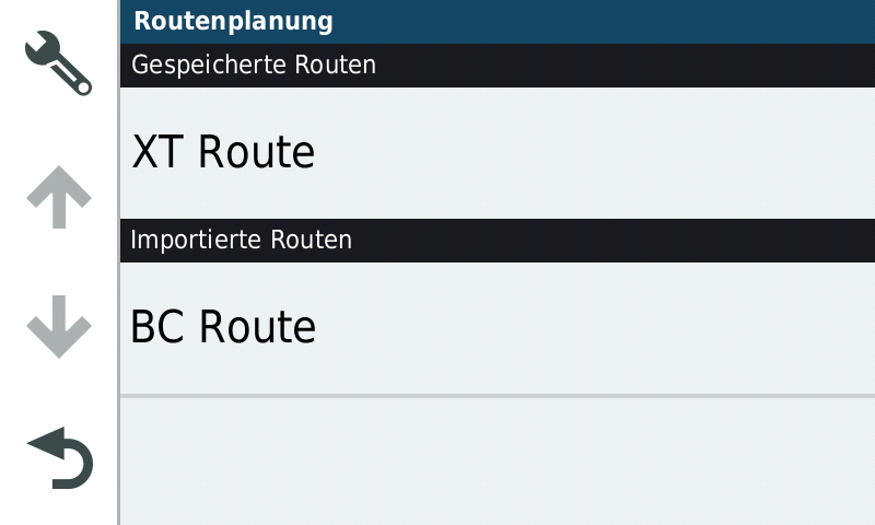

jfheath wrote: Tue May 23, 2023 4:47 pmOh thanks !
Have at lease one route created using trip planner on the 595. Call it something imaginative like "XT Route".
Have at least one route on the 595 that has been transferred from Basecamp, and has then been imported. Call it "BC Route".
Select Apps->Trip Planner->Saved Trips. The XT shows a couple of black 'headers' across the list. One above the 'Saved Trips' and another above 'Imported Trips' Scroll down to see what the 595 has please. Where are XT Route and BC Route located in the list ? Under what Banners ?

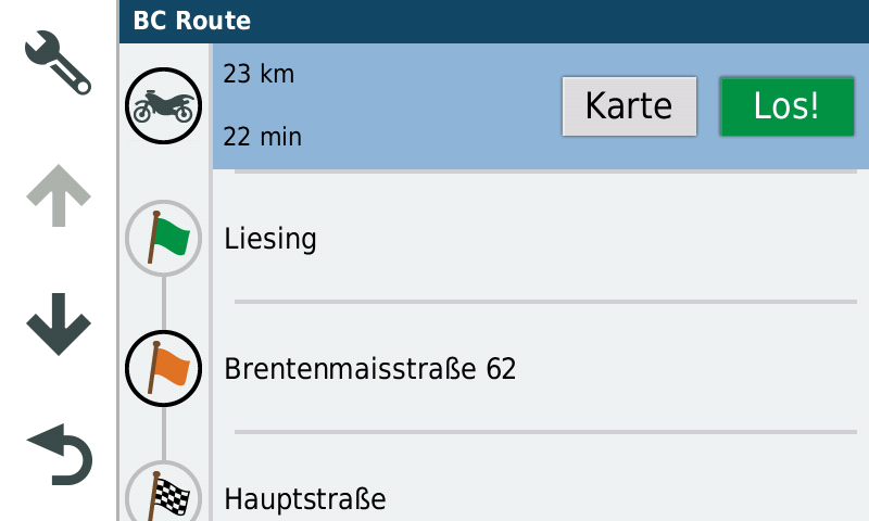

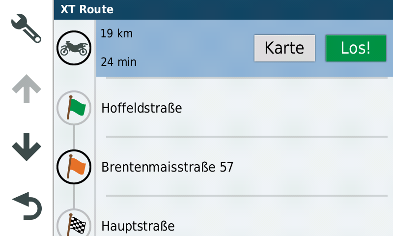

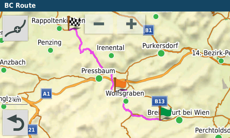

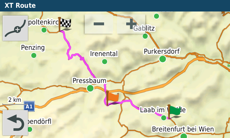

Here we go - as expected, 'BC Route' is listed under 'Imported Routes' and 'XT Route' is listed under 'Saved Routes'. Named the routes just as suggested from you, two nearly identical, short routes with one via-point in the middle, 'XT Route' was created directly on the Zumo 595 with the route planning tool and 'BC Route' was made with Basecamp and transferred via drag-n-drop to 'Internal Memory' - after a restart of the Zumo 595, it asks if i want import a new found route to the route planning app, and i said yes...
Did check, where the files are stored - 'BC Route' is in 'GPX/temp.gpx' and 'GPX/current.gpx' and 'XT Route' is only in 'GPX/current.gpx'. I add both files, if it is helpfully for you. Also here are the screenshots from the two routes:
Route planning app
Route planning app
XT Route (created on the Zumo directly)
XT Route overview
XT Route overview
BC Route (created with Basecamp and imported)

BC Route overview
BC Route overview
