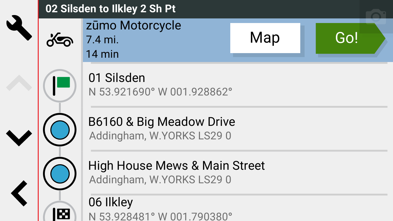

An example of this is shown in the scrollable route on Pic 1 here: app.php/ZXT-P07. I had taken the precaution of creating my Via Points as Waypoints - which were never changed.

The attachment is of an altered route captured as a screenshot from my XT2 in Sept 2024 - before v 6.10 came out, showing the changed shaping point names and the charactersitic addition of town and county and/or postcode..
