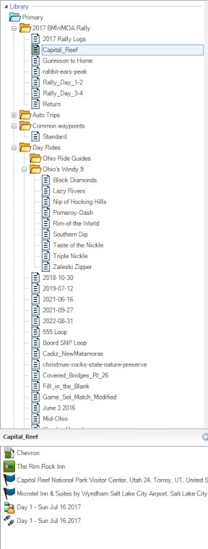

Just as an a exercise, I once did put all of my Basecamp database on the SDcard.
It's been a while but I think I had to do a bit at a time or Basecamp choked on all the data if I did it in one swell foop.
20,526 waypoints (mostly POI), 400 routes, 301 tracks, 30.9 MB. (would easily fit in the nearly 8GB free in internal memory.)
Viewed three routes a time in landscape mode, five at time in portrait, no way to search or sort or SEE the contents before importing, it was useless.
_____________________
twowheelstom wrote: Thu Feb 08, 2024 11:27 pm another benefit of Exporting and Copy/Paste to the Card is file folder naming organization, and removing those waypoints and routes from XT Internal Storage will help to keep the Favourites Saved section less filled up, and also the Trip Planner Saved Routes to a minimum, I mean less routes in there that I no longer want to see. and using computer File Explorer to organize all the waypoint and route files by Folder names, much easier to identify items than to see many routes on the Basecamp > Memory Card > User list, because looking at routes on the User list in Basecamp will show routes that might not even have an connection to a Trip I'm doing
My feeling is that the less data on the XT, the easier it is to use, and routes/tracks/waypoints unrelated to the trip I'm on have no business being on the SDcard at all (or Internal Memory), so they do not appear as User Data in Basecamp. The original routes and tracks are already tucked away in the appropriate lists, list folders, and sub folders in the Basecamp database. Old data is erased from Trip Planner and Tracks very soon after completion. Active logs are transferred as tracks (often combined) to the associated list if I want to keep them, and Travel History is cleared. Old and excess waypoints in Favorites/Saved is not as much of an annoyance, as I seldom use that feature. I do clear it occasionally, keeping only a few that points that see regular use. "Recents" usually meets my needs for simple take-me-there-now routing to get back to lodging, etc., and any more complicated routing is done in Basecamp.

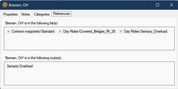

Good organization using Basecamp lists and list folders keeps waypoints together with their associated routes and trips, so I nearly always know why I have them. If one should go astray, I can just double-click it, which shows me exactly where it is on the map and its properties. The References tab will tell me which lists and routes contain the waypoint. Clicking those names will take me to the associated list or "Open" the route.
