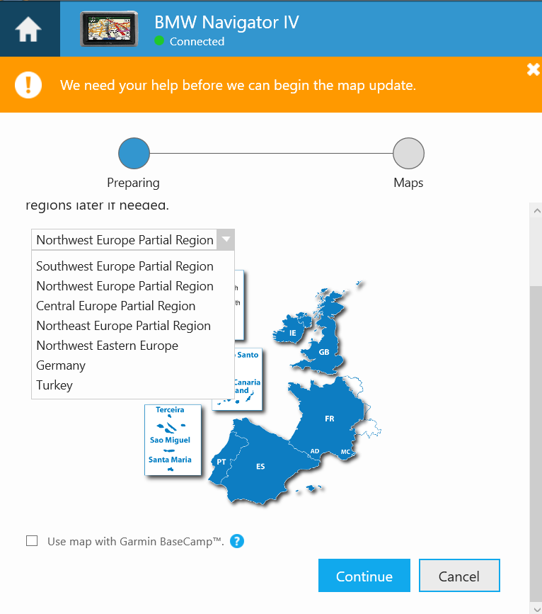

Having recently replaced the PC the first job was to reinstall Garmin Express and Basecamp during which I was surprised and happy to see that I could update the maps which I couldn't do when last posting and also install to the PC/Basecamp which I also couldn't do. OK, it's CN Europe (well part of it) NT 2025.1 but that will do me as many years younger than my existing maps! When installing, at 54% I received an error message signalling an update failure but on checking the 660 the maps seemed to have installed OK and I read somewhere that these messages aren't unusual? We shall see.

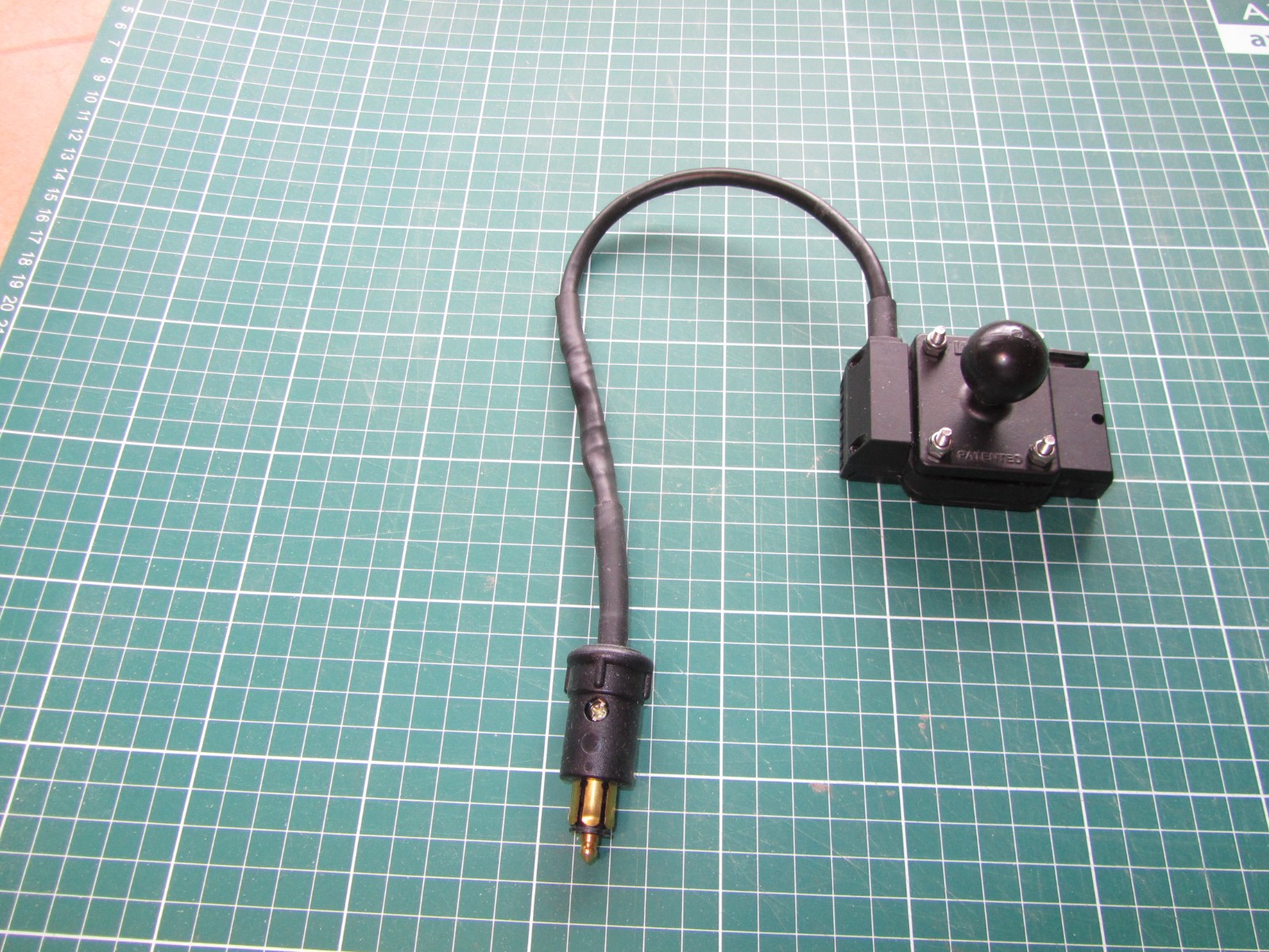

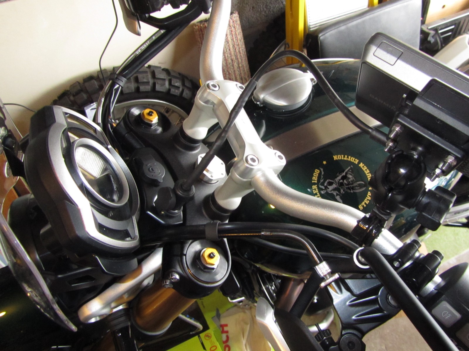

Other thing was to 'butcher' the sat nav harness as there was no way I wanted it as standard on my Scrambler. I say butcher but you have to be more gentle than that, well in some ways! First job was to cut off the unwanted additional leads and splitter connector as I only wanted power. I then cut back the cable and cut back all the non-power cables and removed the sheathing etc. I cut these cables to different lengths to avoid any shorting and covered in heatstrink. I then soldered a short length of smaller diameter twin-core cable to suit the entry of the right-angle male connector used on the Tiger 1050. This was a slight mistake as when checking on the bike decided that a straight connector would be better. Fortunately I had a straight Powerlet in the box from when I'd originally bought the sat nav, so no delay there. The cable diameter was a little too small so I built it up with layers of heatstrink.
With this done I should be good to go but I decided to have a look at the links kindly provided by another member. Both had opened up the cradle (which I'd done in the past) so I did this again. I didn't want to disturb the cable entry as they'd done but whilst I'd staggered the redundant cables I thought I'd make doubly sure and remove the plug on the circuit board and cut the cables off. With this done I put it back together. Unlike with a lot of things nowadays you can easily take the cradle apart.
Fitted it and the sat nav to the bike and nothing! Slight twist of the Powerlet though and it powered up, brilliant! Might just need a bit of a clean as it seems to be good quality and made in Germany. Failing that I'll get another or use the right-angle one.

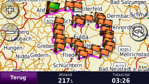

Someone I know, who has made the change from the 660 to an XT, gave me his 660 to experiment with. I tested it with TripManager, see here the results: https://frankbijnen.github.io/TripManag ... zumos.html
To summarize:
- You can use MapSource, BaseCamp, or online planners like MRA and Kurviger.
- Transferring routes/tracks can be done with Mapsource, BaseCamp, or TripManager.
If you use routes with Route Points (Doesn't matter if they're Via Points or Shaping Points) the 660 will show 'Flags'.
I have never driven a 220 or 660 with spoken directions, but I suspect that they are all announced. If you dont like that you can send a track from the route and on the 660 convert it to a route. Make sure to set auto recalculation to OFF if you do that.

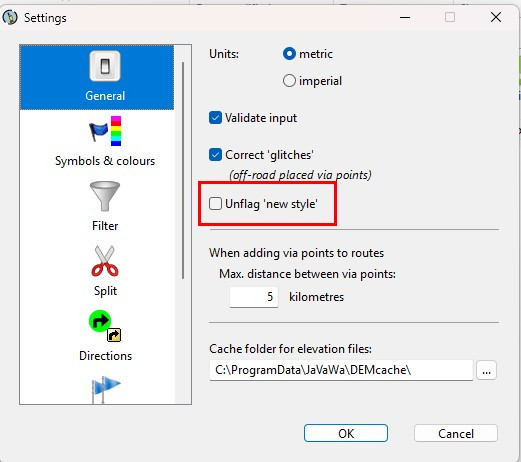

If you are using BaseCamp and you have the same maps in BaseCamp as on the 660, there is also a tool called RTWTool https://www.javawa.nl/rtwtool_en.html that can 'unflag'. For the 660 you have to use the 'old style unflag'.
It will not work for MRA or Kurviger.

Yes, those were the options I got when I installed 2025.10 and that part of Europe that includes the UK suits me fine, as does the map update considering I managed with the original map from 2012!
