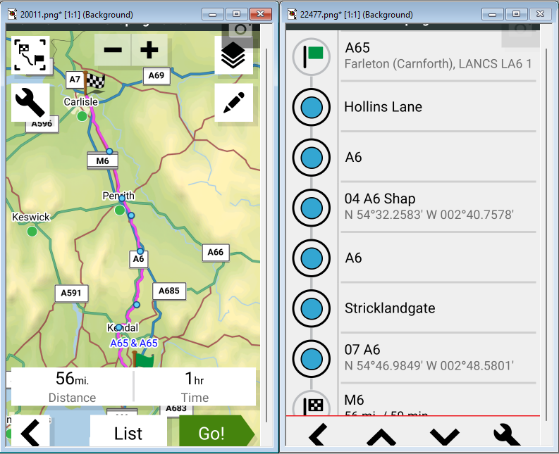

Here is the route as imported by the XT2 - The route has 2 via points - start and end, and 6 shaping points to keep the route on the A6.
The M6 is closeby. There is a junction just after the start point, and another just before the end point.
Another junction with the M6 is just south of point 04 A6 Shap.
The finish point is at the service station on the motorway, but the shaping points are placed to keep the majority of the route on the A6.
Bluetooth is turned off, so the route cannot synch with the Tread App.
Test 01 All ShpPts Before Synch.png (317.55 KiB) Viewed 630 times

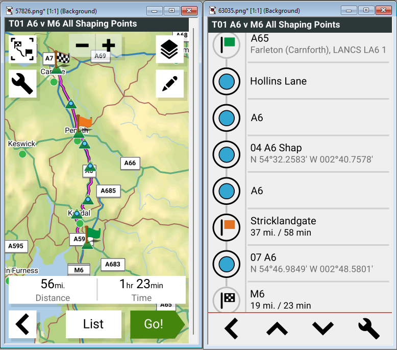

After Bluetooth was turned on, the route eventually synched to the Explore / Tread cloud. And then synched back again.
Good news was that the route stayed on the A6 - previous attempts at this had resulted in the route north of point 04 and the shaping points all moving on to the M6 motorway.
Not so good is that one of the shaping points has been altered to a via point.
The image below shows the altered route with the altered shaaping point - now a Via.
Test 01 All ShpPts After Synch.png (346.86 KiB) Viewed 630 times
Note that this morning when I tried to repeat this behaviour, it did not do this. It moved the points from 04 to 07 onto the M6 motorway.
App version 3.00.11

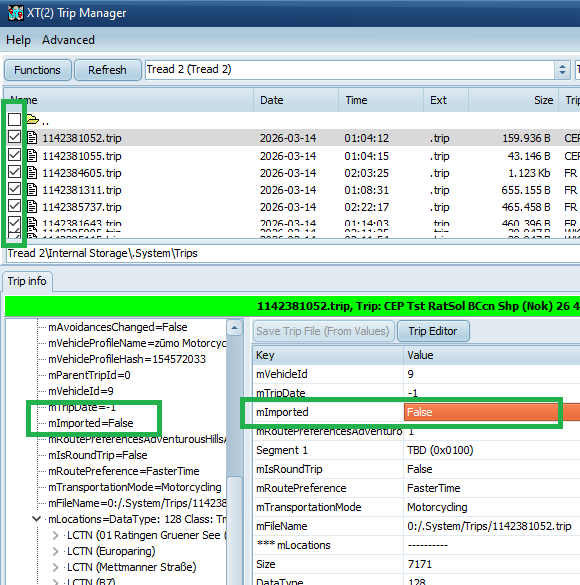

I’ve noticed, I don’t know if it’s always been this way, that the “Imported” flag is set to [False] for routes imported from the Tread app.
PNG-Bild (neu) (4).png (73.22 KiB) Viewed 617 times
And with the “imported” flag set to false, there shouldn’t be a RUT problem, right?
