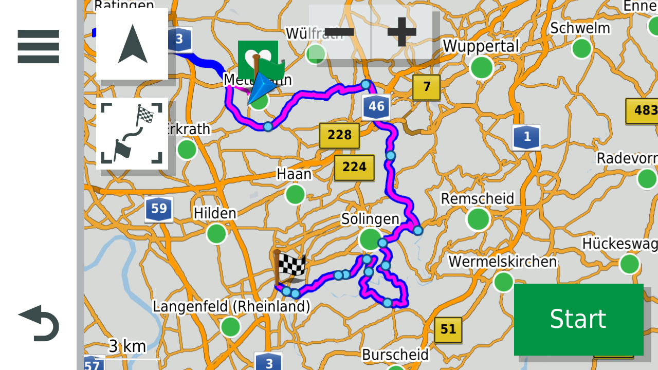

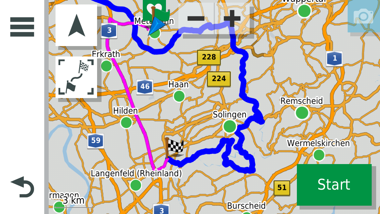

Am I correct in the observation that your CEP misbehaves only after the route has been recalculated ?
You may want to skip to the question that I ask at the bottom of the page. Thus is a rather long reason for me asking it.
A while ago with the XT1, I checked whether or not CEP recalculated the whole route. For the tests that I carried out, it didn't. I tested this with routes prepared on Basecamp that had via points at junctions along a main road. It had 2 or more shaping points on side roads - first one side of the main road, then the other. This forced the route to follow a zig-zag pattern crossing to the other side of the main road at each of the via points. Without the shaping points it would take the main road.
I then set BC to strip out the shaping points on transfer to the zumo or gpx file. This can be done in Edit-Options-Device Transfer in BC. Or by right clicking on the route and selecting 'Strip Shaping Points'. The route stays intact without the shaping points and providing that the maps are the same, the Zumo should not recalculate it. So if at any point the route is recalculated, you can tell immediately because will follow the main road, and you can tell whether the calculation affects just the current segment to the next via point, or the entire route.
When navigating, Some operations result in the entire route being recalculated. Going off route is one. Pressing skip is another.
Sometimes only the segment to the next via point is recalculated. At the time of the test on the XT1, Closest Entry Point calculated only to the point of entry. The remainder of the route was left intact.
I did something similar with the. XT2 and it did on one occasion calculate to the end of the route. I didn't do any further tests to find out when and why because I thought that I knew why.

Sometimes When the XT1 and XT2 recalculates a route, they both change the nature of the route: It no longer follows the rules of going from route point to route point. It now follows the line that it has recalculated. That line may pass through all of the route points - or the XT2 may have moved them - but they are of no consequence. When you pass by them, they are not removed from the list of remaining points ( which you can determine by tapping skip to see which point is next, and then say no ). And if you wander off the route it will direct you back to its recalculated route at the closest point to your current position. Just like a track-trip *. If you by pass a route point, via or shaping, it doesn't care - the point just disappears from the map.
And when you go off route it chops the route into two parts at the closest point. It discards the part before the closest point, and calculates a new section from your current location to the new closest point. This is now the current route, and the green flag is planted at your current position.
This means that if you deviate from the route in a mathematically awkward way, so that the closest point is behind you, you end up in a never ending cycle. RUT behaviour. Yes indeed - track-trips display RUT behaviour.

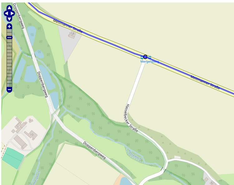

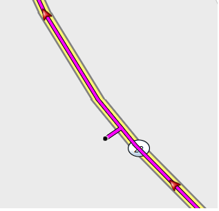

Couldn't resist testing this. Here is what I did:
Imported the GPX in BC. Kept only the route: CEP Tst RatSol BCshp Nok
Duplicated that route as 'Fixed'. Moved/deleted all shaping point placed at junctions, or requiring a Turn. Basically the shaping points that were already identified as problematic.
Created Waypoint 'Mettmann' to serve as point where to start the CEP from.
Attached the GPX in the zip.
Transfered Trips,Tracks and Waypoints to my XT (!) using TripManager.
Using the GPS simulator set my location to Mettmann
Started both routes with CEP.
Nok was indeed NOK Fixed was indeed fixed My conclusion is that CEP does not like shaping points that require a u-turn, nor does it like shaping points on junction. Let me share my theory on that.
A junction (or crossing) is a point where the gps coordinates are the same, but the road Id's can be different. If the Zumo, after recalculating, thinks that the road crossed is meant, it would require also a u-turn.
In the attached example 'Humans' mean 'Mettmanner strasse', the Zumo might think you mean 'Hasselbecker Strasse'.
Now I fully understand that my results may not apply to the XT2, and that on the XT2 other parameters come in to play.
But to me, with my XT, this is just a variation of viewtopic.php?p=5801&hilit=glitch#p5801
I do agree:
- 'mImported' is not related.
- Recalculation can play a role, especially if the recalculating changed (slightly) the coordinates of routepoints. As was observed with Tread and the XT2
Frank

I think @FrankB has nailed it. I found that my problem route did have a shaping point at an intersection and another just off the road. (I think this was due to a map update since the route was created, but it doesn't matter.)
Those points were miles past the section of the route which needed to be recalculated by CEP, so I am surprised they had an effect, but they did. I fixed the points and CEP behaved well for imported, saved and recalculated versions of the route.
Another thumbs up for Frank

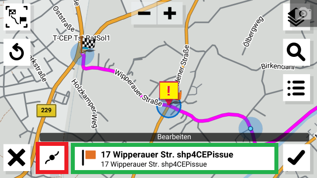

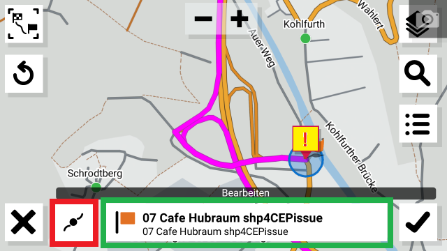

@smfollen en keep in mind
@FrankB I will forward these workaround images to Garmin Support if necessary.
Garmin Support already has the demo with the error and the description shared here, including the error but without the solution chapters.
