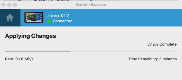

If I could only download the maps to Basecamp...
I used Basecamp without issues a few years back with various Garmin devices.
Currently, with the XT2, I am unable to install maps on my Mac.
It starts the download:
Screenshot 2025-12-31 at 12.35.24.png (32.94 KiB) Viewed 601 times

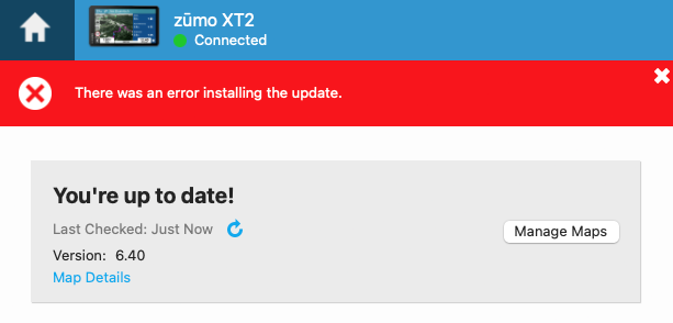

And then when it is around 70% it fails. I tried a dozen times.
Screenshot 2025-12-31 at 12.37.13.png (35.03 KiB) Viewed 601 times
Such a shame.

Which version of Garmin Express are you using?
jacq
Posts: 4
Joined: Tue Dec 30, 2025 5:53 pm
Post by jacq »
Latest - 7.27.0.0.
I just reinstalled it. Removed all cashes and it is still the same.

jacq wrote: Wed Dec 31, 2025 2:47 pm Latest - 7.27.0.0.
I had some problems with the latest versions, and following the advice of people on this forum, I went back to version 7.22. So far, no problems. Here's a link where you can download the Mac version. Give it a try ;)
https://garmin-express.uptodown.com/mac ... 1014764974
If that doesn't work, we'll have to think of something else.

It doesn't work.
It fails each time around 73% (~5.8GB of City_Navigator_Europe_NTU_2026_30.gmap)
Garmin Express (macOS) consistently fails XT2 install maps to the computer at a similar file size (~5.85 GB, ~73%) on every attempt.
Logs show that multiple map components are successfully downloaded and written before the failure, e.g.:
Starting transfer to [D6210330A.img]
Finished transfer to [D6210330A.img]
Starting transfer to [DA215020A.img]
Finished transfer to [DA215020A.img]
Starting transfer to [D8526110A.img]
Finished transfer to [D8526110A.img]
Starting transfer to [D6159330A.gma]
Finished transfer to [D6159330A.gma]
Immediately after these successful transfers, the install aborts with (that is from log file):
Error Domain=NSPOSIXErrorDomain Code=12 "Cannot allocate memory"
UniversalMapInstallToComputerOperation -> Changed to [Canceled] / [Failed] phase
Same errors regardless of Garmin Express version.
I have plenty of disk space, plenty of free RAM.
I even tried mounting another SSD drive to the folder where it downloads those maps.
Another hours lost on something that Garmin broke! They had great devices few years back, it is just downhill sadly.
