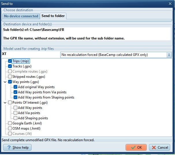

jfheath wrote: Thu Oct 30, 2025 4:25 am Some other things it will do:
Thanks once again for putting TripManager in the spotlight.
I would like to add 'if requested' to the quoted remark though. Meaning it will only do that if requested in the 'Send to' dialog.
You have to select the items to send by ticking the corresponding checkboxes.
(Screenshot from V1.6, not yet released)
BTW: TripManager would not have evolved to such a useful tool, if it weren't for the help and support of this forum. To name a few @jfheath, @smfollen, @proofresistant, @Peobody, @Stu Apologies to people I forgot to mention.

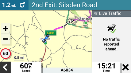

Edit - Additional Info from XT2 screen
1. Live Traffic is displayed in the right hand pane - by selecting the option from the lower right 3 bar menu menu.

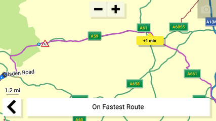

2. A Traffic map can be obtained by tapping on the Live Traffic Pane. Zoom in and scroll around.

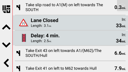

3. Tap the banner on top of the main Navigation Screen
This gives a list of turns up ahead, but you can scroll down and see info about traffic delays.
309211 33pc.png (41.3 KiB) Viewed 666 times

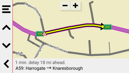

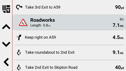

4. Tap one of the incidents on this list.
Here's another example: Tap one of the incidents - eg Lane Closed
311564 33pc.png (54.63 KiB) Viewed 666 times
This gives a cose up view of the location
321375 33pc.png (93.35 KiB) Viewed 666 times
The 3 bar menu in the top left corner gives the option to avoid this incident.

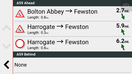

5. From the main menu, select Apps -> Traffic -> 3 bar menu -> Incidents
This gives a list of all of the traffic related incidents and road closures in the area. You can then select the road that you are on
You can then tap on the individual incident to get a close up map of the location.

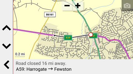

392836 33pc.png (50.07 KiB) Viewed 666 times
In this particular example, the road isn't closed at all - it has been made one-way. Diversions were in place on the road, but the stanav was quite happy to navigate straight through the one way system in the wrong direction. The black arrow on the map indicates which way the traffic should flow. But to be fair on the XT2 - that white/red circle is at the wrong end of the road. It isn't closed to traffic from the east.
The Zumos do not seem able to extract the fine detail from road closures. IT is either closed or it isn't. So brief road closures some of the time (eg for 10 mins), or as in this case - closed in one direction only. It seems to chose Yes or no. and sometimes gets it wrong. So I tried the simulator going in the opposite direction. It told me that the A59 was closed and was switching to a new route.
So this issue is not a Garmin or an XT2 issue at all - it is whoever is creating the mapping for road closures !

Many thanks, tried #5 today on the M6. The XT2 showed the ahead and behind as your example. It did get confused as I passed through some congestion as on the far side of it it was in the "ahead" section, but with an arrow showing that it was behind me.
A PITA having to scroll through all the minor roads in all directions before being able to select the M6. But, who buys Garmin GPSRs for sensible software?
