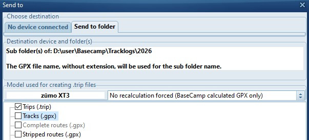

Re: Introducing TripManager
To summarize:
- If you use a GPX file created by MRA (or any other routeplanner than BaseCamp) and want to be sure that the trip on the Zumo is the same as what is planned, the ONLY option you have is to send a track, and on the Zumo use 'Convert to trip'. But this will remove all Shaping and Via Points.
- If you use a GPX file created by BC you can also use the option 'No recalculation forced'. The trip will be as it was in BC. But beware! If the Zumo recalculates for any reason, the result could still be different.

This could be key, and could simplify things for me. Consider this scenario.
- I create a route in Basecamp named "Damascus Day 3".
- I get that route and track onto the XT by using TripManager and doing a "Send to device" selecting the Trips and Tracks options.
- I then decide to modify that route. The route name will not change.
Normally I would delete both the route and the track using the delete functions on the XT, connect it to the PC, and then send the modified route using TM. This morning, I had the XT connected and TM running so decided to see if I could do the deletes and the resend without disconnecting the XT. Deleting the route (.trip) is obvious but I got hung up with not being able to figure out how to delete the track. Are you saying that I could have simply done the same "Send to device" from TM with the modified route and that would have overwritten (with prompts) the existing .trip and track on the XT?
FrankB wrote: Mon Apr 13, 2026 4:31 pm - Yes, you can delete a track using TripManager. Use the 'GPX' button, select the file(s) to delete, Click on 'Functions' and select 'Delete selected files'.
The GPX button reveals a file named "Tracks_Damascus Day 3.gpx". Am I correct in understanding that deleting this file will delete the track from the XT, but may not be necessary if it will be overwritten?
Peobody wrote: Mon Apr 13, 2026 6:31 pm Are you saying that I could have simply done the same "Send to device" from TM with the modified route and that would have overwritten (with prompts) the existing .trip and track on the XT?
Yes.
Side Note: Suppose you had set 'Show on map', and possibly another color, on the XT, you will have to do that again.
FrankB wrote: Mon Apr 13, 2026 4:31 pm Am I correct in understanding that deleting this file will delete the track from the XT, but may not be necessary if it will be overwritten?
Yes.
But again. This will only work for the XT, when NOT connected to Explore.
FrankB wrote: Mon Apr 13, 2026 6:52 pm
Yes.
Worked great! Thanks @FrankB .
