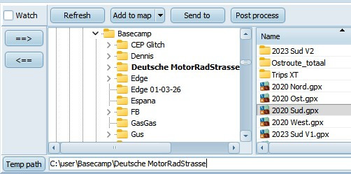

First thing to do is navigate to the folder (directory) on your hard-drive where your GPX files are.

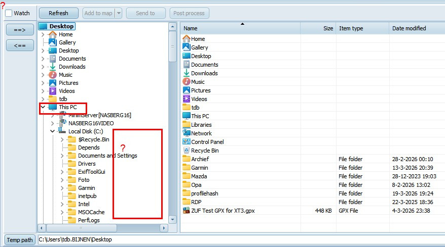

Open 'This PC', next open the folder where you keep them. A sample folder from myself:
Once you select a GPX file you can 'Add To Map' or 'Send To' to transfer the gpx to your XT2

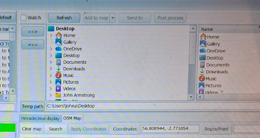

Oop North John wrote: Thu Mar 19, 2026 9:24 pm What I'm seeing on startup of Tripmanager is below.
But isn't that the contents of your computer on the right?
Can't you just go to to your local folders with your gpx files?
PNG-Bild (neu) (8).png (307.5 KiB) Viewed 1814 times

My problem, I think, is that Ive been taking the files from the XT2, not from the PC. Will try the working on them in Tripmanager, and then sending the "saved" route etc to the XT2.
