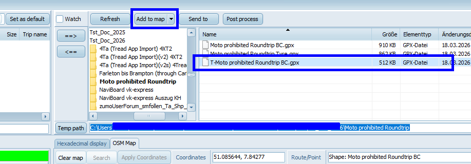

Re: Introducing TripManager
I saw that, but the "add to map" is also not active,and try as I can, I can't get the far right block to show anything to select, looking at the XT internal storage as I know I have tracks generated from a route there.proofresistant wrote: Thu Mar 19, 2026 8:54 pmI've already sent a tip like that beforeOop North John wrote: Thu Mar 19, 2026 8:38 pm While I'm at it, can routes and tracks be shown at the same time on the map?
"... When use the map to see what the actual route data on the device is, may also compare it to the original by adding the origin track to the map: ... "
Dont navigate into the XT2 storage on the right upper block. Keep that for your Windows files.Oop North John wrote: Thu Mar 19, 2026 9:03 pm I saw that, but the "add to map" is also not active,and try as I can, I can't get the far right block to show anything to select, looking at the XT internal storage as I know I have tracks generated from a route there.
The Left-upper block is for the Device Storage.
When you select one GPX on the right upper block you should be able to add it to the map
The right block shows the contents of your computer—that's where you transferred the GPX file to the GPS, right?Oop North John wrote: Thu Mar 19, 2026 9:03 pm I can't get the far right block to show anything to select, looking at the XT internal storage as I know I have tracks generated from a route there.

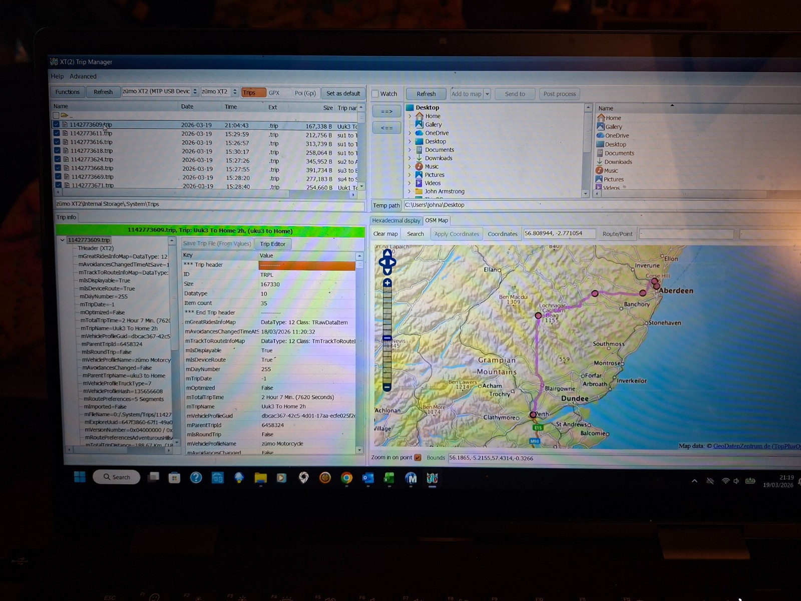

As far as I'm aware I haven't transferred anything to my XT2, the right click has no link to do that. I wondered if the arrows next to the upper right block were for transferring data, but that's only because I've seen that logic used on other programs.proofresistant wrote: Thu Mar 19, 2026 9:10 pmThe right block shows the contents of your computer—that's where you transferred the GPX file to the GPS, right?Oop North John wrote: Thu Mar 19, 2026 9:03 pm I can't get the far right block to show anything to select, looking at the XT internal storage as I know I have tracks generated from a route there.
What I'm seeing on startup of Tripmanager is below.
