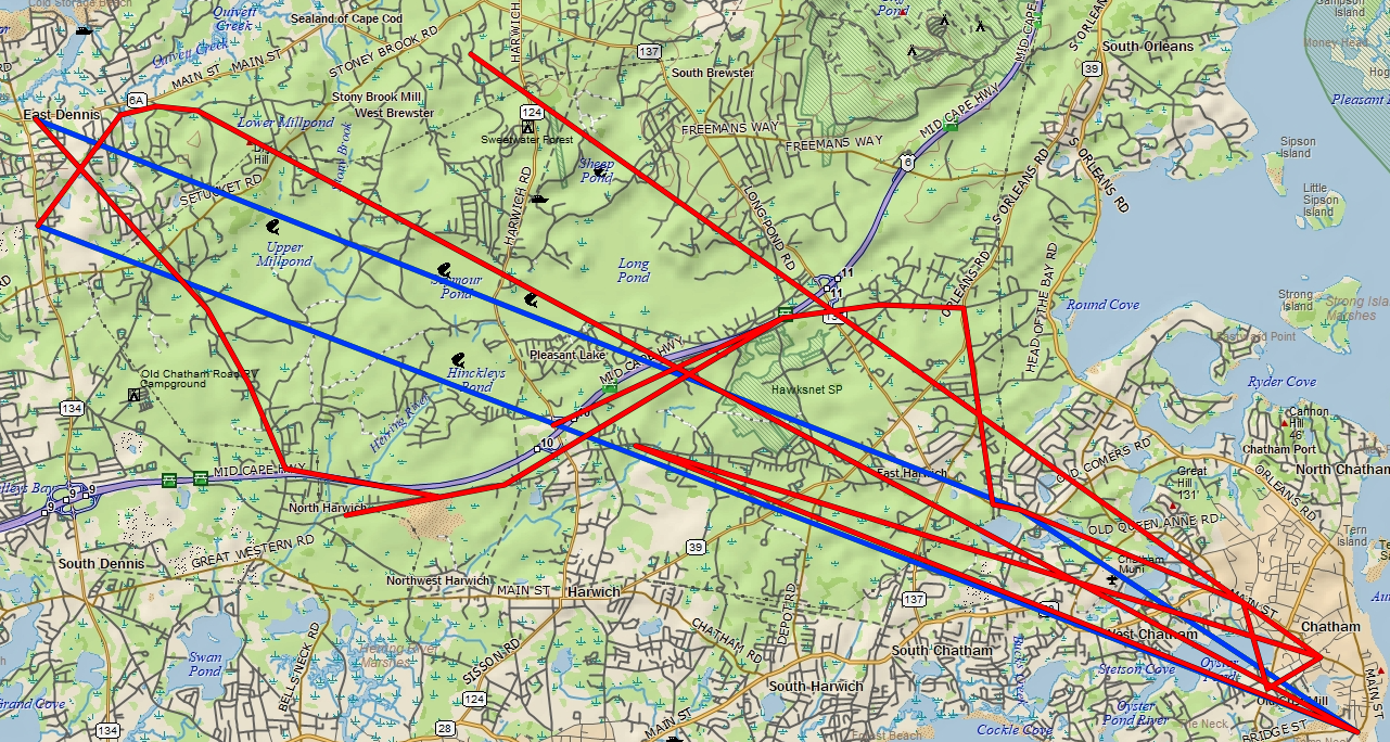

The little bit of experimenting I just did is consistent with @jfheath history post above. The "routes" there are not like the routes we know.
Among other things, I went back to the original case I had reported a year ago and went to the "route" that had been exported to the Explore web page back then (shown in blue below). It is made up of the 4 via points from the original route - shaping points were apparently ignored, as reported back then.
I applied the convert to track function @proofresistant pointed out above (thank you again).
I did get additional points, unfortunately, those appear to be random locations in a random order. A few do [randomly?] happen to be near shaping points in the original route but most are not. The order of them makes no sense at all.
The result is shown in red below. The root of the issue remains a mystery to me. Maybe Garmin will figure it out and fix it sometime before I get too old to ride a motorcycle ... but I'm not counting on it.
In the mean time, I will continue to leave the Tread App out of my world. Basecamp, Trip Manager and a USB cable are serving my needs quite well.
