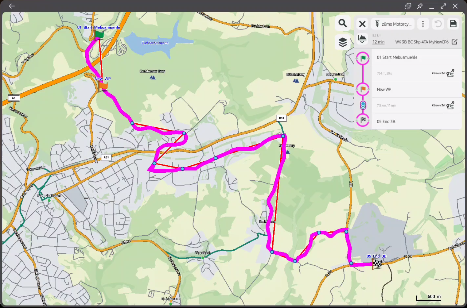

Take a look at my result for the route from @Lanso :
proofresistant wrote: Tue Sep 30, 2025 9:48 pm So I tested it.
See both attachments.
The route imported via the Tread app was very similar to the original, with no significant different shaping points.
The route imported via zumo XT2 was very different from the original, with visible different shaping points.
The fact remains that I (or rather we, have no (certain) explanation) as to what happens there, when, why or how.
What is still unclear to me is whether the Tread app also has or recognizes the ghost points between the waypoints or not.
Explore doesn't seem to have them.

smfollen wrote: Wed Oct 01, 2025 12:57 pm The issue seems to be with the Tread app syncing with the Explore database / website. That Explore simply does not support shaping points at all ...
@smfollen, I wouldn't be so sure about that.
What I can observe leads to a different conclusion.
I suspect that shaping points are stored somewhere on the web, somehow.
You can see, may a few unexpected, results with shaping points web shared, in my example.:
  • 0 initial i powered off my zumo XT2

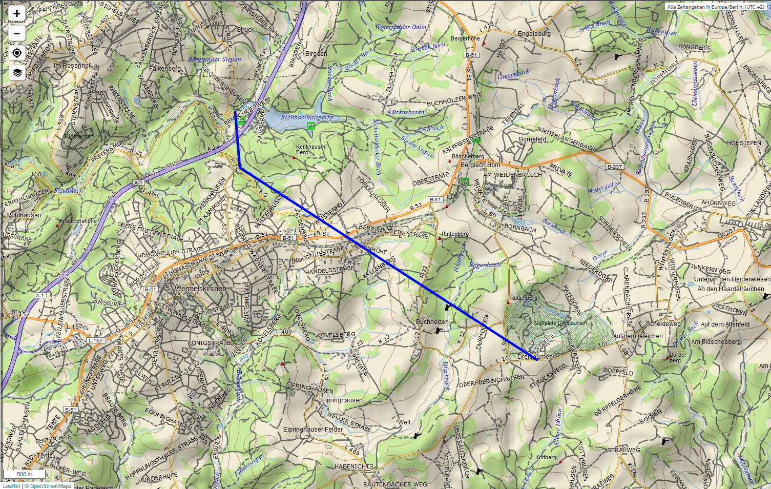

  • 1st i created a Route in Tread App
    1 WK 3B Tread App 1 Route.png (2.47 MiB) Viewed 324 times

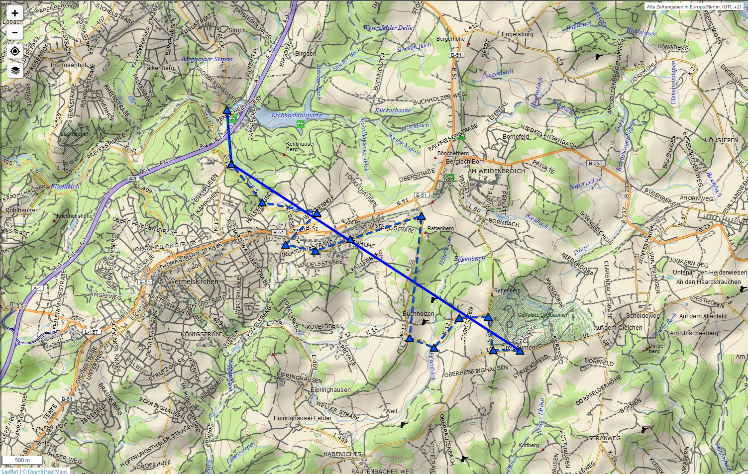

  • 2nd i observed the Route on Explore Web site
    2 WK 3B Explore Web 1 Route.png (3.71 MiB) Viewed 324 times

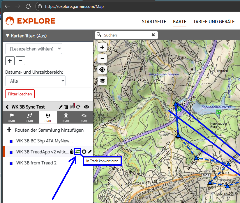

  • 3rd i converted the Route to a track, on Explore Web site also.
    ups ther are additinal Points, looking like the shaping points
    3 WK 3B Explore Web 2 Track from Route.png (3.7 MiB) Viewed 324 times

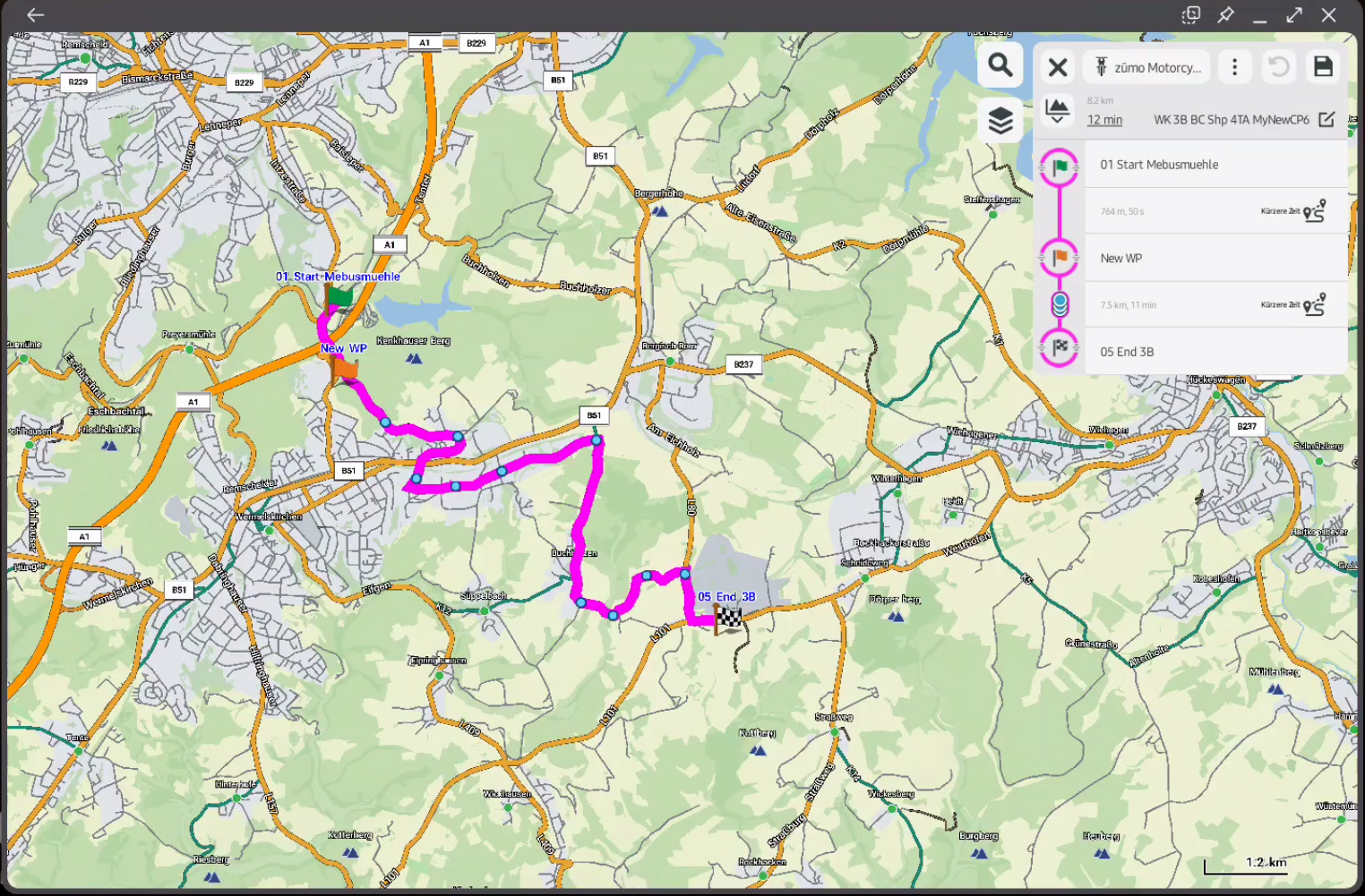

  • 4th i checked both in Tread App, Route and Track are looking like (nearly) same
    4 WK 3B Tread App 2 Track and Route.png (1.75 MiB) Viewed 324 times

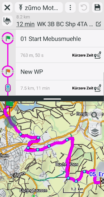

  • 5th i powered on my zumo XT2
    i checked both in zumo XT2, Route and Track are looking like (nearly) same, at this moment
    5 WK 3B zumo XT2 (viaTreadApp) Track and Route.png (924.74 KiB) Viewed 324 times

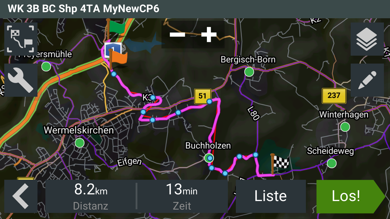

  • 6th i checked again in Tread App, Route looks like a little bit different
    6 WK 3B Tread App 3 After zumoXT2 Sync.png (1.81 MiB) Viewed 324 times
  • Intermediate step, i powered off my zumo XT2
  • 7th i started my second Mobilephone and checked Results Tread App.
    the data comes over the air from Web, include Shaping points
    7 WK 3B Tread App (2nd Phone) Sync via WLAN only.png (270.27 KiB) Viewed 324 times
I can clearly see my set shaping points, even on the Explore website, even if I don't recognize them as such first.
After i converted the TreadApp Route with Shaping Points to Track, the points apperas.
Only when the Tread app “cooperated” with the zumo XT2 were shaping points still there, slightly shifted, but the route was still usable as planned.
And my Last Demo Step shows, my second Phone got the Shaping Point from Web also (where Garmin is storeing which Detail, who knows).
However, @smfollen youe are right, it is very probably true that the Explore website does not seem to calculate Routes.

@proofresistant Thank you for all of the testing and images you posted. I am trying to take a detailed look at it all. If you don't mind, would you clarify for me, your statement
Did you convert the route to a track on the XT2 or with the Tread App?
I ask because, I'm not aware of any functionality on the Explore web pages to convert a route to a track. It is entirely possible that I'm missing something of course.
Posts: 512
Has liked: 39 times
Been liked: 97 times
Germany
Post by proofresistant »
smfollen wrote: Thu Oct 02, 2025 1:59 pm Did you convert the route to a track on the XT2 or with the Tread App?
Hi @smfollen,
I converted Route 2 Track on the Explore page.
Explore convert Route 2 Track.png (855.84 KiB) Viewed 283 times
The Tread app, the zumo XT2, and the Tread 2 are apparently unable to convert a route to a track.
I discovered the function on the website rather by accident while “playing around.”
I don't know if anyone needs it, but I personally don't.
