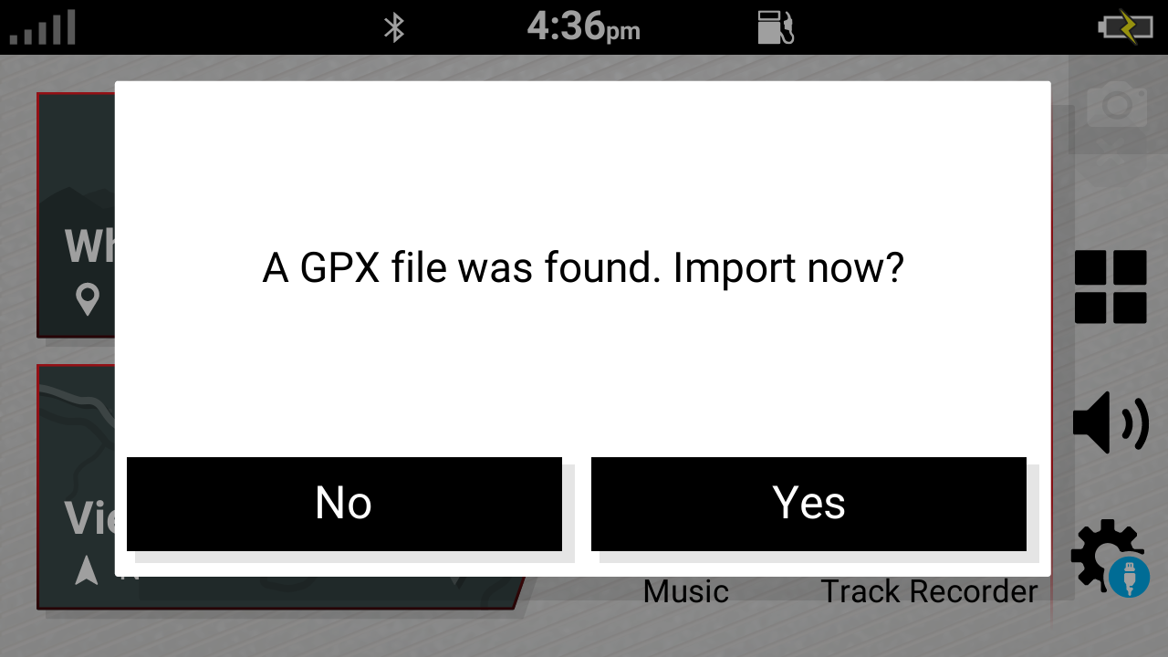

Next I copied your original file to the Garmin/GPX folder on the sd card in my XT2 and then rebooted the XT2.
I think the XT3 is similar, but might vary slightly from what is below.
On restart, it asked

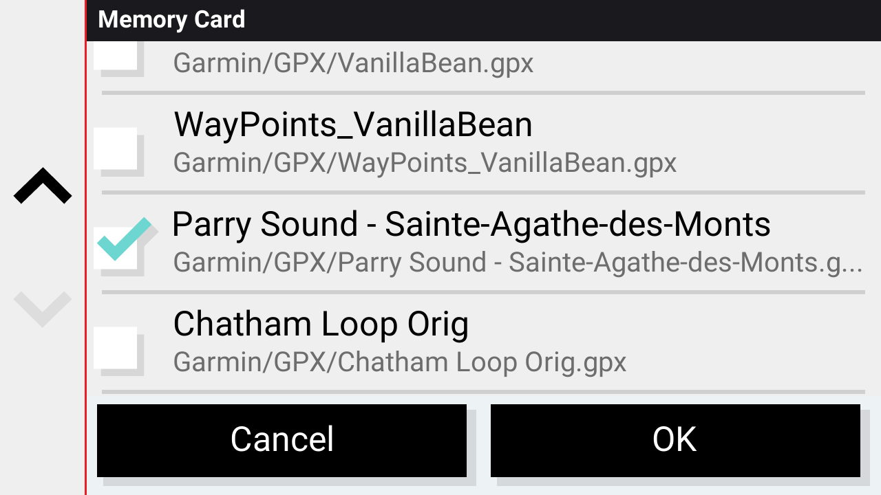

I tapped Yes then selected the gpx file I wanted to import

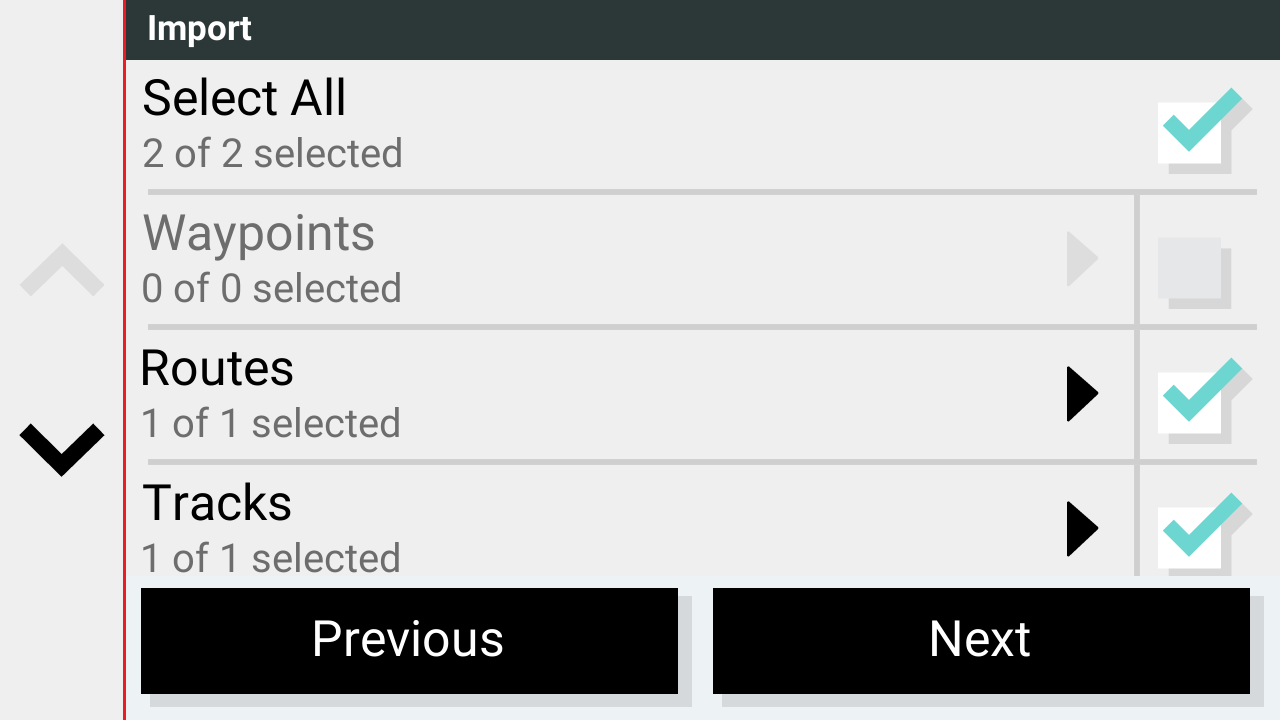

I tapped OK, then tapped the boxes to select both the route and the track (either or both can be selected as desired)

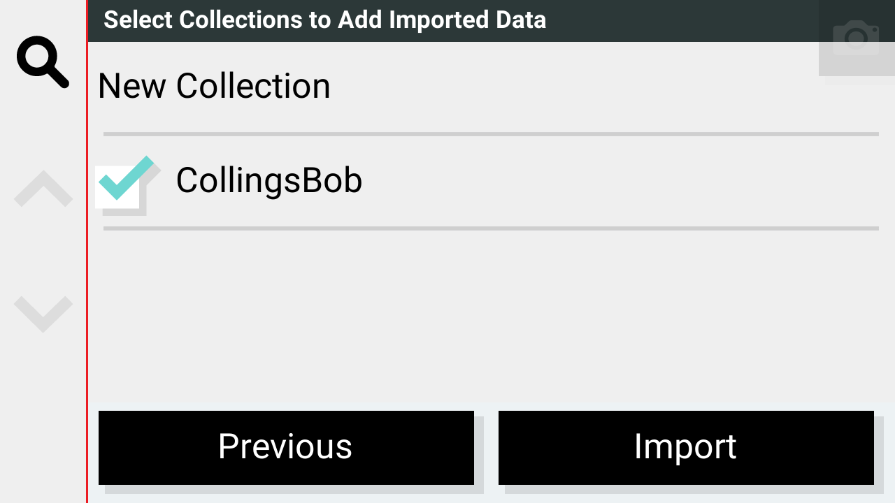

I created a new collection, which is optional, then tapped Import.

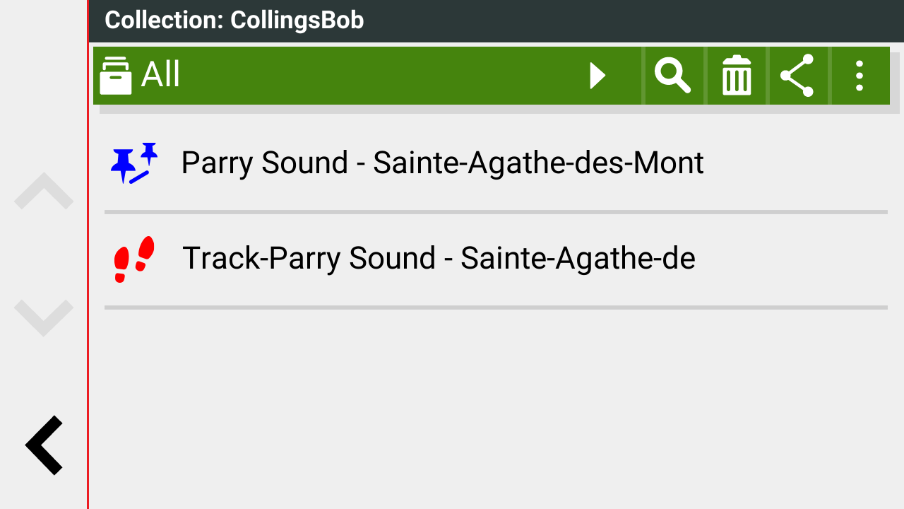

After import, I tapped the Route

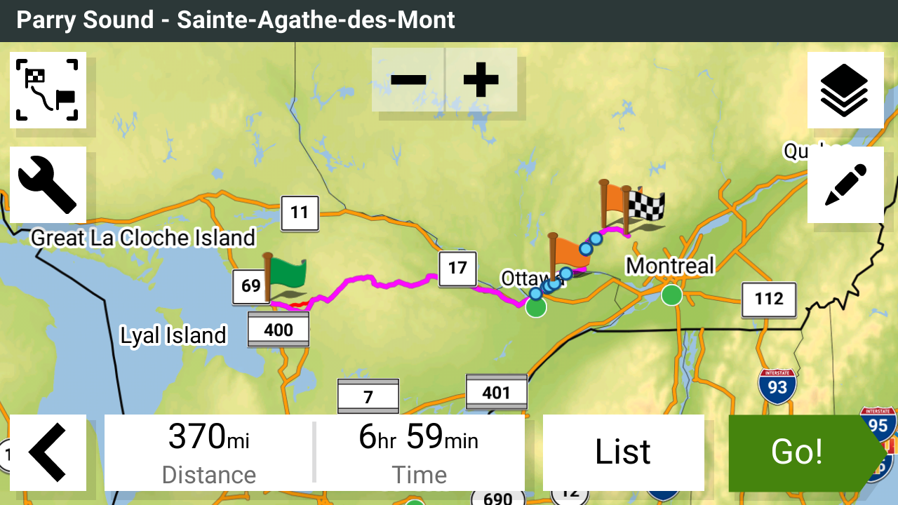

Then "Go" to begin navigating.

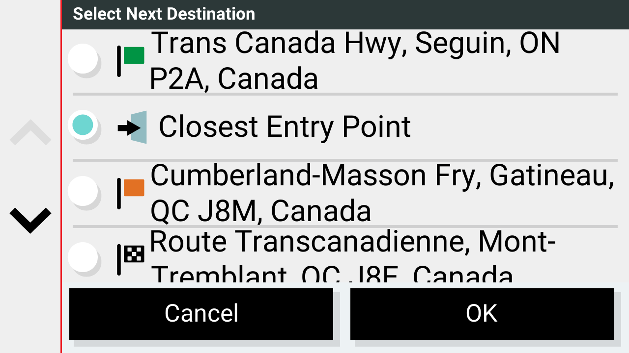

The "Select Next Destination" screen is poorly named, in my opinion. It is asking where you want to join / start the route. I typically use Closest Entry Point, which is the default.
Tap OK here to begin navigation

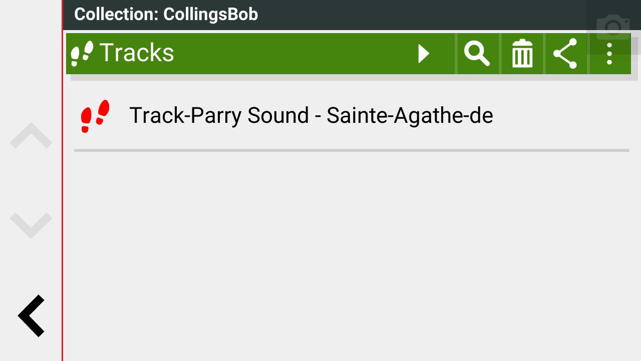

If you instead want to follow the track, you would select Tracks on the top line of this screen,
then select your desired track.
