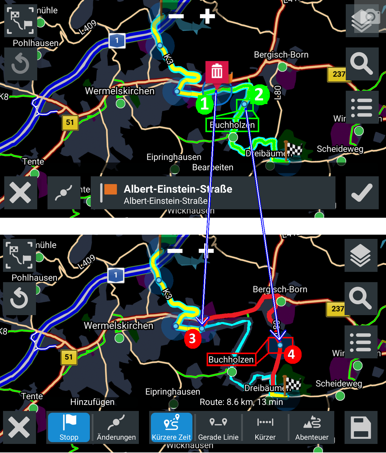

Here is one example (may significant discrepancies for only in my eyes)
371030 [via 2 shp] 373303.png (1.22 MiB) Viewed 305 times
  • 1st Action:
    There were well-placed VIA (screen point 1) and Shaping (screen point 2) in my route.
    I changed a VIA (screen point 1) to a Shaping point in the zumo XT2.
  • 2nd Result:
    The zumo XT2 automatically moved (screen point 1), which is now a Shaping point, slightly to the left (screen point 3).
    So far, so good and acceptable.
    But it also moved the previously well-placed (screen point 2) to a completely different road (screen point 4).
The effect is now less than ideal.
Now about 4-5 km of a beautiful route is ruined :-(
I now drive on a main road with traffic lights and avoid the beautiful little country road through "Buchholzen", which has little traffic.
All without the Tread app, only in the zumo XT 2.

@proofresistant Interesting. I certainly believe you - I just have not had that experience myself.
